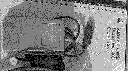

One of the TIL articles you linked to on your spreadsheet discussed the low power ADB mouse.
It has an icon of a circle with a flat top on the label. A quick check of my pile suggests this mouse is common.
However, the version with a 1 inch plug seems to be a little less common. Here is an image from an eBay listing.
1764697910324.png [View]
1764697804995.png [View]
Fizzbinn
Charlottesville, VA
Joined: Nov 29, 2021
Posts: 256
Likes: 262
Dec 3, 2025 - #20
>> David Cook said:
One of the TIL articles you linked to on your spreadsheet discussed the low power ADB mouse. It has an icon of a circle with a flat top on the label. A quick check of my pile suggests this mouse is common. View attachment 25043 However, the version with a 1 inch plug seems to be a little less common. Here is an image from an eBay listing. View attachment 25042 Click to expand...
I never knew that about these ADB mice, interesting! I have a bunch of them, but none with the 1 inch plug.
