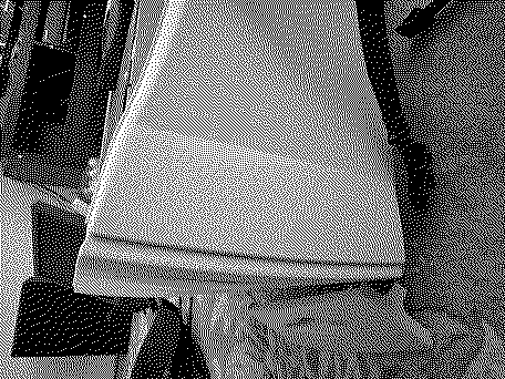

Thanks to a generous short-term loan of several original bezels for the PM9600, I have been able to produce accurate 3D model reproductions of the PM9600 / G3 front bezels. Big thank you to @xenocide21 for the loaned parts!
Here are the 3D models for general usage, please be sure to refer to the licensing for anything other than personal use:
Top Panel:
Special thanks to @XodiumRetro for the short-term loan of an original top bezel, which was used as reference.
  • Blank Top Panel Bezel for Power Macintosh 9600 (Thingiverse)
  • Floppy Drive Top Panel Bezel for Power Macintosh 9600 (Thingiverse)

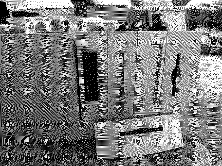

It's the top panel, the floppy panel (the one on the very top). Those are the ones that seem to go missing or go loose. I have seen the top floppy panel go missing on 8600/9600/G3 on eBay, but there is no 3D print model for a replacement.
Liked by Stephen
Stephen
BetterBit
San Francisco
Joined: Sep 5, 2021
Posts: 215
Likes: 264
Jun 19, 2024 - #10
>> chikorita157 said:
It's the top panel, the floppy panel (the one on the very top). Those are the ones that seem to go missing or go loose. I have seen the top floppy panel go missing on 8600/9600/G3 on eBay, but there is no 3D print model for a replacement. Click to expand...
Ah yes. The geometry on that is challenging. Some folks offer 3D scans but I personally think the quality is inferior versus recreating the CAD file - and modifications become more challenging if it's a scanned file.
If someone wanted to loan me one of these then I could try to recreate it.... But it may take me several months.

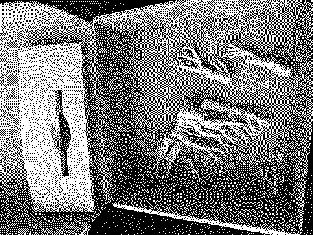

I managed to get a 3D printer to print the floppy panel. Took several tries, but it worked out in the end.
To print this, print it on the flat side up, and use tree/organic as supports. Doing it face down and face up with supports do not give good results on a FDM printer. I used Polymaker Matte PLA Filament multed white for this.

I managed to get a 3D printer to print the floppy panel. Took several tries, but it worked out in the end. To print this, print it on the flat side up, and use tree/organic as supports. Doing it face down and face up with supports do not give good results on a FDM printer. I used Polymaker Matte PLA Filament multed white for this. Click to expand...
Nice work - mine came out so badly (with tree support and the same orientation) I tossed it straight into the bin.

What 3D printer are you using along with filament? I used a Bambu Labs A1 (he bigger version). You might have to use glue stick as with the tree/organic, the right side peels up and messes up the print. I catch it in time so it won't waste that much filiament.
Now, I probably have to buy another spool.
