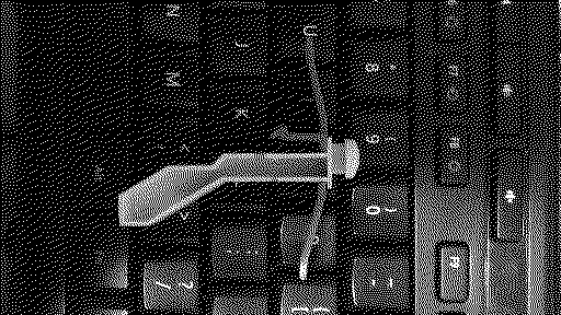

Nov 1, 2021 - #11
It's not quite up to my standards yet but getting there.

Nov 2, 2021 - #12
I'm just gonna go out and say it. That button is not one of Apple's best designs. The print looks good though!

First test printed. It seems pretty robust, so I'm pleased. I may make a few revisions though. I'll use the original button bit so that it looks original.

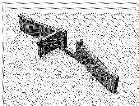

Nov 2, 2021 - #19
Here's the STEP and STL files to add the clips back to an original button. I'm tempted to make an extension of the original button to make it so it won't need to be pressed so much and get stuck sometimes like the original.
License under CC BY-NC-SA 4.0

Branchus
Posts: 237
Likes: 518
Nov 2, 2021 - #20
>> alxlab said:
Here's the STEP and STL files to add the clips back to an original button. I'm tempted to make an extension of the original button to make it so it won't need to be pressed so much and get stuck sometimes like the original. Click to expand...
Just in case no one has told you, this is a really clever solution.
