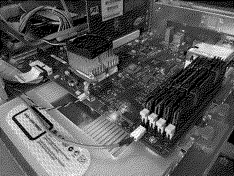

Before anything I would plug em in and see if a cuda reset will bring them back to life. My B&W on occasion has shown absolutely no life after fiddling with its bits - that behavior included non-functioning power button. It presents like a completely dead box/psu, so if you dont know, its easy to assume the box is dead. Anyhow, reset the CUDA and the machine comes back to life, so give that a try. Here's a pic of a rev2 logicboard for @flag4 .
The cuda is behind the cpu heatsink and will be the button on the left. The button on the right is the power button. The difference between Rev 1 & 2 logicboards is found in the corner of the lobos CMD chip which is hidden under the PCI slots. Rev1 is PCI646U2 and Rev2 is 646U2-402.
