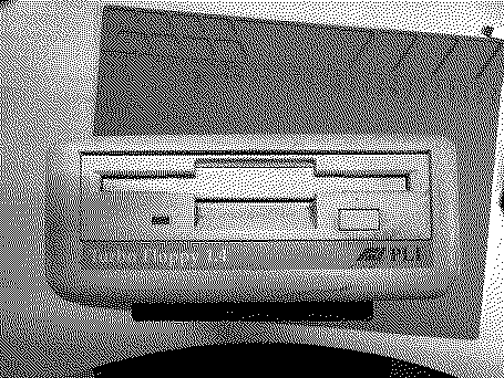

This is an interesting device as unlike other SCSI floppy devices - like the IOmega Floptical - it requires no driver to work on the and can boot from 1.44mb floppies. That means you can use it on a Plus or SE or other non-Superdrive Macintosh computers.
Booting From a System 7 Disk on my PowerBook 170 (just what I had setup on my test bench at the time):
Identifies as a DISK type - (ID5) - which is a bit odd - thought it would be a removable:

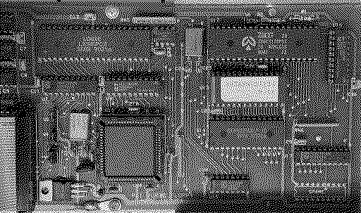

But where this gets really interesting is in the way it works - there are 2 ROMs chips on the floppy to scsi adapter board (which I've dumped) that contain a SCSI Driver and Apple Partition headers - well one does - the other one is 99% blank besides a PLI vendor string. This means if we can extract and craft the Partition in such a way we could inject it into a disk - a BlueSCSI could boot a 1.44 Macintosh Floppy image!

The last interesting part here is there seems to be copy protection on the ROMs themselves - after they load the Floppy driver into memory it blanks out all the driver/partition data - so when you try to do a raw read of the SCSI device where the disk driver and partition would be - it's just a bunch of `0xF6`

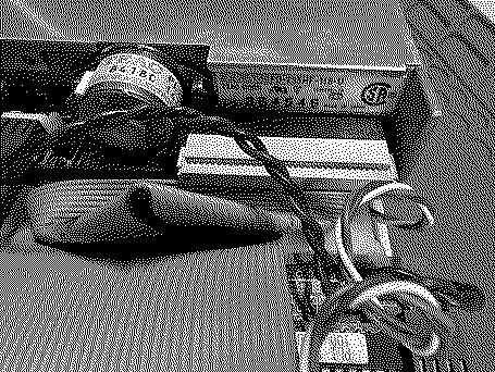

OK, back to the black NeXT "SuperFloppy". The drive inside mine is a Sony MP-F40W-1Y (spindle label) and/or MFD-40W-1X (side label). A front LED header is unpopulated, as is the space for a regular power connector at the back. (Some IBM PS/2 2.88M drives did have an activity light).
Here is a shot of the SCSI bridge board:
I'm happy to try and dump the ROM if someone can recommend the right equipment.
