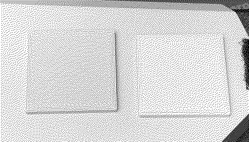

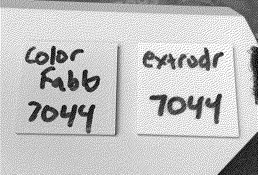

Update: 2/1/2022 - I would stay away from the Extrudr filament. It's too light, and might be a bit too cool as well.
Update: 1/31/2022 - Looks like I'll have the Extrudr filament today. Hmmmm. ;)
UPDATE: 1/19/2022 - we have a potentially less expensive match?
I just found this. Spool cost plus shipping is lower than colorFabb, plus you get more in a standard roll. I have some inbound for color testing.

Upside: no minimum orders. Just place an order, they whip up a batch and they send it out. Beware: it's expensive.
[Image: IMG_2174.JPG] RAL 7044 PLA

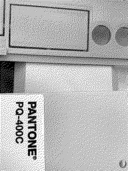

Just a note: I'm working on getting custom colored PLA 3D Printer filament, PANTONE matched, to the Platinum color of Macs and Apple ][s of a certain era. I have already gotten a PANTONE match chip and matched it against a cleaned and sanded internal part from a Color Classic. It's not perfect, but it passes the 1 meter test easily, and even the 30cm test if you aren't a colorphile.
This project will likely. however, result in a certain minimum buy in of spools. I have no idea what that cost will be. $200? $2000? No clue. The upside is that once this is done, future orders can be single spools, and then that color will be available to everyone. Another upside: PANTONE does the color match after the filament has been printed, so it will be a true printed match, and it's fully certified official PANTONE color.
I have the question to the manufacturer out now regarding pricing, so I'll report back here with that, if anyone wants to join me in the purchase.
Here's what the color match looks like. Chip on top. Color Classic speaker housing on bottom. Photo taken from about 16cm away.

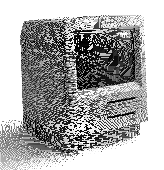

Interesting. According to an article on Quora:
Apple called the warm, desaturated gray "Platinum," part of the Snow White design language created by Frog Design and used from 1987 to 1990. It replaced the beige "Pantone 453" tone from the previous generation Apple ii and Mac products. The Platinum color lasted well into the 1990s across Apple's portfolio, although it was copied by many competitors. The Colors of Apple http://docs.info.apple.com/article.html?artnum=866 "Apple does not normally use PMS color charts or Pantone color numbers to designate the platinum color that is now the company standard. Our platinum color number on a coded PMS chart is somewhere between 420 and 421, somewhat closer to 421. (This depends on the age of the chart and the light source used for viewing it." The subject has come up on reddit: r/VintageApple - Help finding a Pantone colour to match Apple's Platinum colour Click to expand...

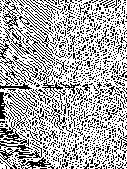

Yup! That's what I thought too. So I ordered some filament colored 421 C (someone had some) and it's just too cold.
PANTONE(R) USA | PANTONE(R) 421 C - Find a Pantone Color | Quick Online Color Tool
Shop for Pantone(R) 421 C samples and products on Pantone. Convert Pantone(R) 421 C color into RGB, Hex, and CMYK values.
[Image: www.pantone.com] www.pantone.com
PANTONE(R) USA | PANTONE(R) 400 C - Find a Pantone Color | Quick Online Color Tool
Shop for Pantone(R) 400 C samples and products on Pantone. Convert Pantone(R) 400 C color into RGB, Hex, and CMYK values.
I sanded to remove any surface yellowing. I used 220, 400, 800, 1600 to ensure that specular patterning from the sanding wasn't affecting the color.
But the PANTONE certified plastic color chip I ordered direct from PANTONE for $20 and placed next to a cleanly sanded interior part from a Platinum style machine doesn't lie.
421C filament on the top. 400 C chip on the bottom. Sanded speaker in the middle.

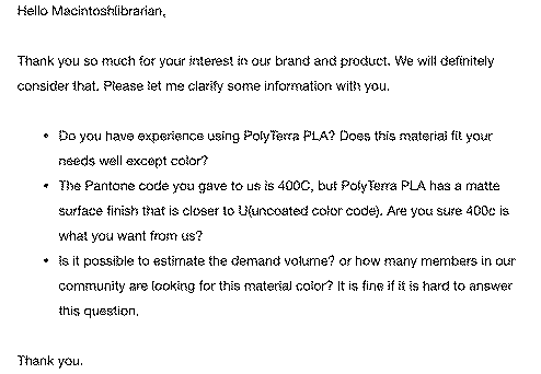

I contacted my favorite filament provider Polymaker about creating a PLA filament in a 400C color.
I love their Matte finish PolyTerra PLA - and the fact that it comes in a recyclable cardboard spool.
I think they are willing to work with us to get this color produced - hopefully at a lower cost than the current source.
Here is the email I received from them.
Let me know if this is something the community wants to pursue!
I dont want to step on anyone's toes here.

That's nifty! If they can do RGB color codes, my color matching (over five items, each item sampled five times then averaged) indicates that the closest match is #BFBCB1.

Joe they are asking about possible community interest? Do you think you would sell them on your store? i am giving a rough estimate that they can sell 50 spools relatively quickly if we can spin up the right youtube videos ;)

You can't match a genrated color with a printed color. Completely different. You need CYMK values, which they will be able to match.
