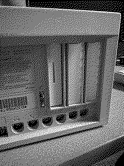

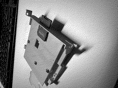

I hadn't even printed the mount because I don't have a spare BlueSCSI. But I'm printing it now, and I'll even print a facsimile of a BlueSCSI so that one might see how it all fits together. I have an awful lot of filament in a color that turned out to be not so great of a match for the projects I wanted it for, so this is an excuse to use it up. I should be able to provide pictures of the assembly this evening.

Here's the rough mock-up using a 3D printed facsimile of the BlueSCSI PCB. I'll be able to get a picture of a test fitment in the Quadra this evening.

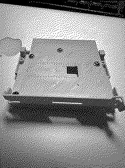

I'm satisfied with the alignment and stability using my mock-up in the Quadra 650. This design simply modifies the available models for the NuBus slot cover to remove the clips, add an SD card opening, and add a bit of length to fuse with the universal BlueSCSI v2 mount. This is then attached with an M3 bolt to a piece that fits snugly over the NuBus connector. I can't be 100% sure of the alignment of the SD card opening as I'm only able to use the 3D-printed mockup of the BlueSCSI v2 PCB. I've joined the waitlist for a BlueSCSI kit from Joe's Computer Museum, so it'll be a while before I can test it myself. In the mean time, anyone who has one already and wants to test it out can download and print the models. I'll have them on GitHub shortly.

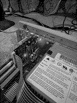

I decided to play musical hard drives and move the BlueSCSI from my SE/30 to the Quadra 650. The mount I designed works pretty well, though I probably should have made the SD card opening just a bit bigger. The important thing is that it works.

As far as I understand, the Q650 and Q950 cases are not much different.
I printed it out and tried it on my Q950 -- it doesn't fit.
I'll try to make the frame not much thinner so that it can move deeper, beyond the petals. In this case, it should be better.
jimfrob
Joined: Mar 21, 2023
Posts: 33
Likes: 36
Nov 29, 2025 - #12
Though it's a touch tricky, this is designed to be levered through the NuBus slot opening and then pulled flush with the outside of the opening. It looks like you were just trying to butt it up against the inside of the opening. If you lever it through and then pull it back snug, the bit that goes over the NuBus connector should hold it relatively tightly in place. I have it in place in my Q650 now with a real BlueSCSI, and it works beautifully.
Liked by V.Yakob
V.Yakob
Syktyvkar
Joined: Sep 6, 2023
Posts: 129
Likes: 46
Nov 29, 2025 - #13
@jimfrob Yes, exactly, you're right. If you put it at an angle, everything works out.
I still have to order BlueSCSIv2 to finally connect it to ATTO ExpressSilicon IV.
