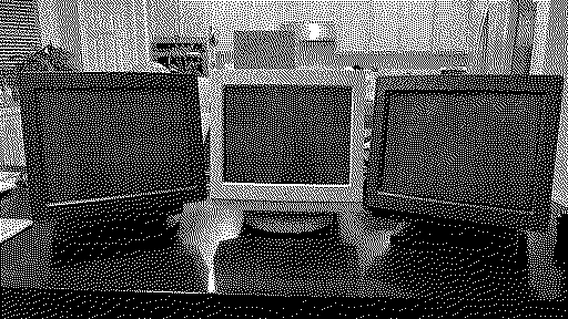

Apr 20, 2023 - #8
Make that 3 dead Trinitrons. I ordered a replacement deflection board for the Multiple Scan 17 thinking that it got damaged during shipping but no luck. I'm beyond annoyed at this point.
If anyone is willing to help me fix them, I'm willing to give away the NeXT MegaPixel with the square base as part of the payment. I don't need 3 of these things and I would really like one Megapixel & the multiple scan fixed so I can put them on display in my computer science classroom.
