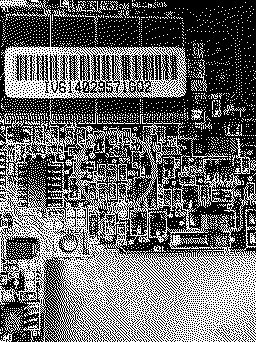

For reference here are the locations of R73/R79, R61, and R52 on the MessagePad 120 MLB.
I realized I had replaced them with 4.7Ohm resistors so swapped them again with 4.7kOhm resistors but the device is still no power.
R73 R79.jpeg (1.7 MB)
