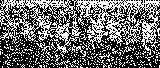

Looking more closely at the original RAM SIMMs, my heart sank. What is this crud? It turns out that leakage from C24 took an unusual path -- across the SIMM slots. Usually, C24 leaks down towards UI18.
As you might have guessed, this means the teeth on the SIMM slots are also covered in crusty corrosion. I did not want to endanger an otherwise working machine by desoldering and replacing the SIMM sockets.
I tested all kinds of chemicals on the corrosion on the original RAM SIMMs: isopropyl alcohol, vinegar, rust remover, deoxit, tarn-x, etc. While some of the corrosion responded, the black areas were unchanged. It didn't respond to a soldering iron with flux. A rubber eraser might have done a little bit, but also resulted in scratching the clean tinned areas.
The black chunks are solid but brittle. Sometimes picking at it will break off a small piece.

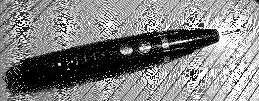

Then an idea came to me: why not use the same tool that dentists use on plaque and tartar? Amazon sells a plaque remover (dental scaler) tool for $25.
Amazon.com: Plaque Remover for Teeth, Teeth Cleaning Kit with LED Light and 5 Adjustable Modes Teeth Cleaner, Blue : Everything Else
Buy Plaque Remover for Teeth, Teeth Cleaning Kit with LED Light and 5 Adjustable Modes Teeth Cleaner, Blue on Amazon.com [check-mark] FREE SHIPPING on qualified orders
amzn.to
It is battery powered. It has a little metal tip that vibrates silently and imperceptively at 40 kHz. If you press it against your finger, nothing happens. If you press it against something solid but brittle, it makes a horrible screeching noise and the brittle object pops off or explodes in a puff of smoke. Think of it like a tiny fast hammer. Flexible material just bounces around. Malleable material like copper gets slightly worked. But, this hard corrosion cracks and crumbles.
Below is an image of the teeth in the RAM socket. The black areas are non-conductive and prevent the computer from functioning. I tried cleaning them with a pink rubber eraser, which only made things worse with pieces of eraser getting stuck in gaps. But, look at the one tooth that I used the plaque remover tool on! While not yet perfect, notice all the black dust that has come off. This took just a couple of seconds.
I cleaned all of the bad teeth with the plaque scaler under a microscope. I then cleaned away the dust with a compressed cleaning solution (MG Chemicals Super Wash). Then I wiped them all with isopropyl alcohol and a sponge cleaning swab. I repeated this process. During the second pass, I noticed I was getting a mirror finish on most of the teeth. Hurray!
And guess what? It worked! The IIfx is fully operational and passes Mac Test Pro RAM tests. (I used new memory -- not the crusty sticks shown earlier).

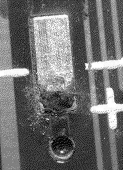

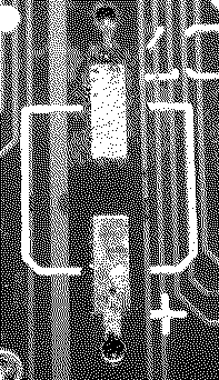

Another good use for the scaler is to remove the crusty buildup on the ends of leaky capacitor pads. This stuff does not come off easily with isopropyl or heat. I end up scatching it off with my soldering iron -- decreasing the life of the iron tip.
Here is an example on an SE/30 pad:
After using the scaler for about a minute... (I should have worked the lower portion of the positive pad a little more)
After wiping with isopropyl, braided copper desoldering wick, again with isopropyl, and retinning with the soldering iron.

No. The movement is so tiny and so fast you feel no vibration at all. The sound is pretty irritating (chalk on a chalkboard).

I think these little units have far lower energy output than the ones used in a dental office. Just received one from Amazon and looking forward to using it.
