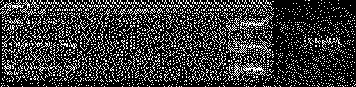

Aug 28, 2022 - #6
There it is, the files have been swapped in the resource article:
1661694753903.png [View]
