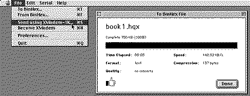

Hello everyone,
For bulk file copying on older Macs, nothing beats emulated hardware such as Floppy Emu, MacSD, ZuluSCSI, and so on. However, for sending small files back and forth, swapping the micro SD card in and out can feel a bit like sneakernet.
I've written a small application that runs on all Macs from the Mac 128K all the way up to the G3, and all operating systems they support. With Tiny Transfer, you can:
1. Send files over a serial cable to another Mac or emulator. No server, AppleTalk, inits, or reboots needed. Just a standalone application.
2. Synchronize the Mac's clock
3. Convert files to/from BinHex (.hqx) format
A limitation of the classic BinHex format is that file comments and file dates are not preserved. For many files this doesn't matter. But, when you want to publicly archive something like original versions of MacsBug, then the dates and comments are part of the story they tell. Tiny Transfer appends this additional information after the main BinHex section, so the file format stays compatible with older decoding applications.
Take a couple of minutes to download Tiny Transfer (ironically the .hqx then needs to be decoded by BinHex or StuffIt) and add it to your 'Tools' folder on your standard drive images. Then, next time you find yourself needing to convert to/from BinHex or transfer a file, give it a try!
- David
Tiny Transfer.hqx (77.7 KB)
Tiny Transfer User Guide and Technical Documentation.pdf (2.5 MB)
