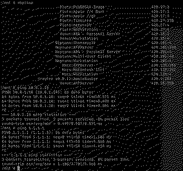

nbplkup in the failed state can still see my jrouter instance running on another host, I forgot to go turn on a Mac:
For versions, 4.0.4 was stable until it wasn't--that's the version I was on when I originally posted about the issue. However, it had been very stable for me until recently. The docker host is running Ubuntu Server 20.04.3 and Docker 20.10.21.

>> scj312 said:
Connecting via IP address did not work in the failed state. nbplkup in the failed state can still see my jrouter instance running on another host, I forgot to go turn on a Mac: For versions, 4.0.4 was stable until it wasn't--that's the version I was on when I originally posted about the issue. However, it had been very stable for me until recently. The docker host is running Ubuntu Server 20.04.3 and Docker 20.10.21. Click to expand...
Alright, it failed again and this time I remembered to turn on some more Macs! Here is the nbplkup result within the container. I also ran some pings to IPs both on and off the subnet. It looks like everything is fine from a network perspective, so the errors from Netatalk are a bit puzzling.

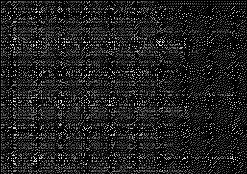

@rdmark Unfortunately, I seem to be stuck in a restart loop once again:
I'll increase log levels so that next time we have something more useful to work with.
Screenshot 2025-04-07 at 6.13.50 PM.png [View]
