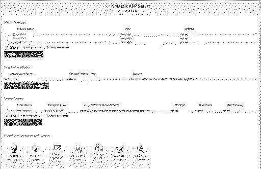

The Netatalk team is proud to present version 2.4.0 of the venerable AFP file sharing suite. Grab the source code, or a Docker image, today!
This version is primarily a future-proofing release, introducing the modern Meson build system, while integrating an embedded WolfSSL as the encryption provider for the DHX and RandNum user authentication modules.
To make a long story short, you can now run Netatalk 2 on any modern OS and still be able to authenticate securely with old Macs (and IIGSes).
It also ships with a range of bugfixes, documentation updates and quality-of-life improvements. See the release notes (linked above) for the full list of changes!
Additionally, a massively improved v2.0 of the Webmin module for easy administration has been released in parallel, with support for all features in Netatalk 2.4.0.
I'm looking forward to hearing your feedback!
