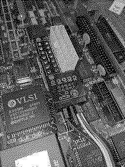

Sep 4, 2023 - #22
Here are the pins used on the Mac SE/30 J12 connector, seen from ABOVE the board. Pay close attention, the four corners are marked with the silkscreen around the connector on the logic board.
(sept 8 edit made a better J12 connector (seen from above the logic board) diagram)
J12 on logic.png [View]
1693826008400.png [View]

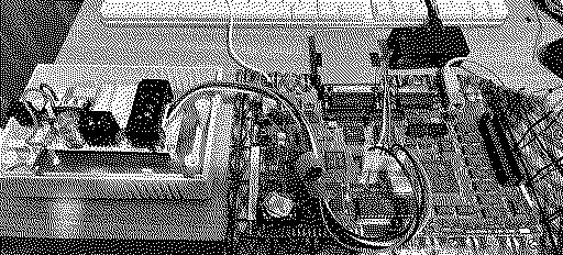

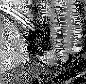

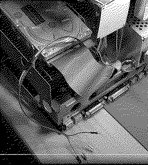

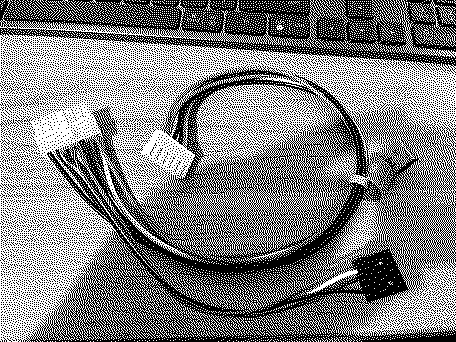

Hi, Great post. Just wanted to share my escapades. I built a few RGBtoHDMI's a while back but after recently getting my Classic back from a friend after about 17 years, and fully refurbishing it. I needed a way to test the logic board in isolation from the Analog board, which took some effort to get working!
I came up with this:
Using an Amiga PSU, which I had rebuilt using a Meanwell RPT-60b PSU which outputs +/-12v and +5v (My bench supply only has one output) I made a test harness so I could non-destructively remove the Amiga connector and fit the harness
I just needed to re-flash my RGBtoHDMI CPLD and then using the last distro select the classic profile which I did in isolation, so once all was connected it started straight up. the aspect ratio doesn't look right but based on this thread, I think I'll give it a tweak when I next remove the board.

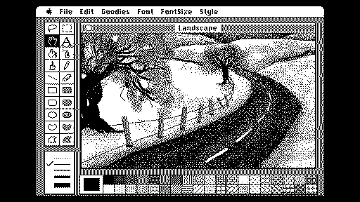

Just wanted to say thanks for this thread. It was very helpful in getting my Mac Classic II in a Box up and running.
Outputting to an iPad 2 screen which runs at 1024x768. This makes for a crisp 2x integer scale from the Mac Classic II's native resolution.

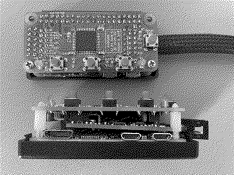

The analog version will just be an additional board the plugs in, in between the Pi and the RGBtoHDMI pHat. you don't need it for this but usually they are removable and are useful if you have other vintage machines with analog RGB outputs.
it is recommended to have the TTL buffer board which, again, would go in between the Pi and the RGBtoHDMI pHat, replacing the analog board, but it is just for protecting the CPLD. I don't have one and haven't had any issues, though your mileage may vary

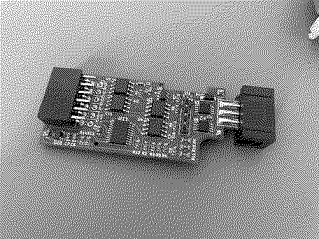

This is an analog board
IMG_1241.jpeg [View]
IMG_1242.jpeg [View]

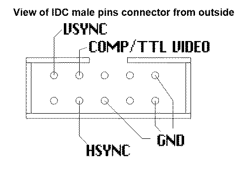

Jul 8, 2024 - #32
I walked back my true and tested method of shove-Dupont-M-wire-end-into-J12-socket for my SE/30 and got myself a J12 passthrough from jcm-1.com hosted by Joe, designed by @Ron's Computer Videos.
The IDC connector at the side of it is perfectly tailor made for Dupont F ends and like always, only uses 4 pins.
being keyed, the passthrough can only go in the right way and is very friendly to letting you put back the logic board in the chassis. It even makes it easier to plug in/plug out the J12 cable into this newly raised socket at the top of the passthrough.
What prompted me to use this is that one time when I opened up my case and moved the logic board around, I accidently disconnected a RGBtoHDMI wire that was shoved into the J12 socket. Not having a "real" secure method for your cables is possible, but it adds verification steps every time you must open or close. It was painless to add this cheap socket to my jcm-1 order (I was in the market for a v2 picogus and various cell battery holders).
The connections are marked with silkscreen on the board near some through holes (which I elected to not use because I'm a dupont cable fan), but not near the IDC connector. After a few minutes spent with a multimeter in continuity mode, you learn which of the pins are relevant, so here's a small chart for your convenience. You may use your preferred GND pin that strikes your fancy the best, of course.
