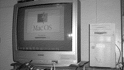

My Quadra 840AV spent it's life being plugged into my TV (to use as a monitor, taking advantage of it's AV out). Even with a 40MHz 68k CPU it wasn't the best gaming machine, but I did have fun with what I could get working with it. I was quite proud of the $5 price tag, so I left that on there. Of course a few months later the machine sat unplugged. And almost a decade later I would find it in my parent's basement while helping them move. Around 2016 I started recapping my Macs, but I was very green and didn't have much of an idea of what I was doing.

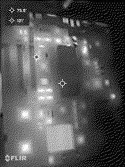

In my latest attempt I purchased a second-hand thermal camera for another project, but I was curious what was getting warm on the board. The CPU was getting hot enough to warrant installing the factory heatsink back on, so I wondered what else may be happening.
The hottest pieces on the board are the voltage regulators, at about 120* F (about 49* C). This is where the red marker is on the photo below. Although when measured with a multimeter, they seem to be doing their job, taking in 12v, and spitting out 5v.
However... something is painfully obvious. The RAM and VRAM (even with slots populated) stay ice cold. At least a few of the ROM chips look "on", and our multimeter probing proved them to be connected to where they needed to go.

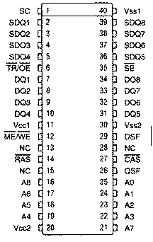

Edit 2: If you are wondering whether the VRAMs are getting power, just check their Vcc lines. Here's a pinout:
VRAM runs from the main 5V supply so if its power was shorted, the '040 wouldn't get hot either. So there's no 5V short. The reason the VRAM isn't cold is probably that it's not being actively used by the CIVIC video chip. In the absence of access, refresh, and serial data input/output a VRAM like that consumes only 10-20 milliwatts and shouldn't get too hot.
