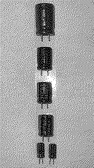

I have a late 90s/early 2000s motherboard that has bad capacitors.
The board currently has standard Aluminium Electrolytic Capacitors.
Since I have to replace them, I'd like to use equivalent modern Aluminium Polymer Capacitors instead.
Is this possible?
I have attached a picture of the original capacitors from the motherboard which are now bad.

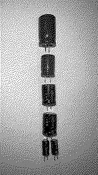

These are the Kemet capacitors I was looking to use as replacements:
A758BG106M1EDAE070
A759KK225M2EAAE685
A750KK477M1AAAE016
A755MS477M1CAAE013
A755KS108M0JAAE013
A755MS158M1AAAE013
