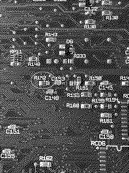

Step 1: Change the Centris 650 into a Quadra 650 by removing the 300-ohm resistor at R151 and installing a 1200-ohm resistor at R152. Some very smart people back in the day realized that the only difference between the two logic boards were the aforementioned resistors per this post.
Here is an after photo of my Centris 650 board showing the resistor at R151 circled in red rotated 90 degrees clockwise from one of the pads, and the installation of the new resistor at R152 circled in orange that I scavenged from a donor board.

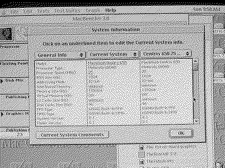

To verify a successful machine ID reconfiguration, I reinstalled the board and ran MacBench 3.0 to see what it said about the current system info. In the middle is the "current system" after resistor changeover verifying that the machine identifies as a Quadra 650 as expected. On the right is the original configuration identification as a Centris 650 prior to the resistor swap.

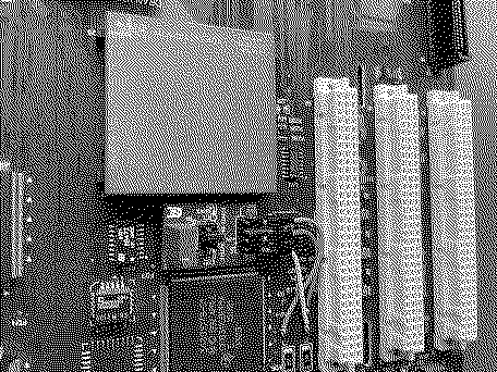

Step 2 is to install Spicy O'Clock per the instructions on Kay Koba's website. Here is a pic showing the end configuration after the original crystal oscillator is removed and Spicy O'Clock wired to the pads.
You can also see the 40 MHz 68040 installed in place of the original 25 MHz 68040.

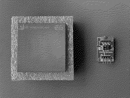

Here is the performance benchmark comparing the stock Centris 650 running at 25 MHz versus the now Quadra 650 overclocked to 40 MHz.
Processor and floating point both see around a 60% increase in performance directly related to the speed increase. The disk mix also saw a slight boost in performance. Graphics saw a sizable improvement slightly above the MHz difference, which I thought was interesting.
I ran the overclocked machine all night with Snooper and saw no issues.
