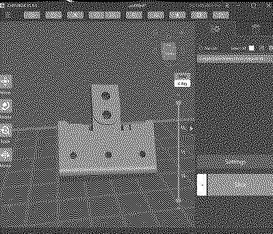

Hey folks,
I recently picked up a few monitors and unfortunately one of them has a broken hinge. I looked for a 3D model for the 15 inch Apple Studio Display hinge but couldn't find one.
Long story short my brother in law did up a STL file for me and we prototyped it on a 3D printer.
Now that I know everything fits I've sent off an order to Shapeways and will let everyone know if it works or not but thought I'd throw the STL file up here either way and upload a new version if we end up tweaking it.
Note: Now available for download from Thingiverse: https://www.thingiverse.com/thing:6590582
AppleStudioDisplay15Inch_Hinge.zip (9.8 KB)

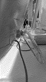

I just bought an Apple Cinema Display ADC 20" (A1038) that also has a broken hinge - broken during shipping. Will this hinge also fit that Apple Display? Thanks!

>> teke978 said:
I just bought an Apple Cinema Display ADC 20" (A1038) that also has a broken hinge - broken during shipping. Will this hinge also fit that Apple Display? Thanks! View attachment 14989 View attachment 14990 Click to expand...
You would need to modify the file. The hinge on these Cinema Displays (and the 17 inch too) is wider than the hinge on the 15 inch. Once I have my aluminium piece back from ShapeWays I might tinker with the file and make different sizes available. Assuming mine works lol

Just arrived from Shapeways. Bit rough in texture but not too bad. Now I just need to get to my brother-in-laws place so he can help me finish them up!
