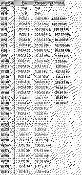

I've had some interesting clock signals from the CPU 'walk the bus' test, compared to the Simasima Repair Guide:
Looking forward to comparing signals with the new-to-me SE/30 that's on the way here.

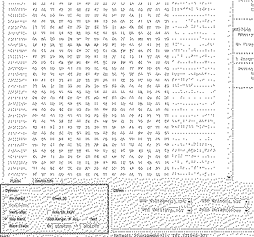

After watching this video on how to read the Mac SE/30 UK6 Video ROM chip:
I was able to do the same with my less expensive TL866-3G:
[Image: TL866-3g.jpg]
Had to select the AMD AM2764A chip in the Xgpro 13.06 software, and disable the Options to Pin Detect and Check ID - was then able to Read the ROM.
This tells me there was nothing wrong with my UK6 Video ROM chip. The missing signals at UK6 are hopefully due to the UD8 being bad on this board.
