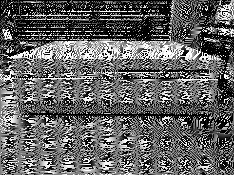

The IIfx arrived in an Amazon basics Paper Towels box that looked a little less for the wear on the outside. Uh oh.

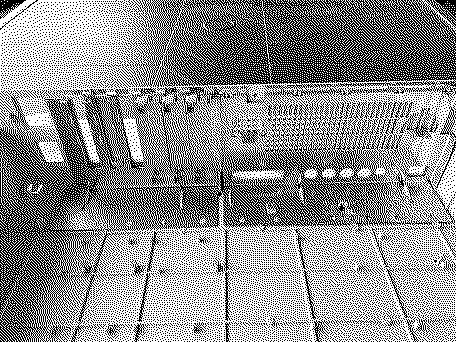

Thankfully the IIfx was padded adequately and wrapped in bubble wrap. Removing the padding and wrapping, I got my first glimpse of the IIfx.

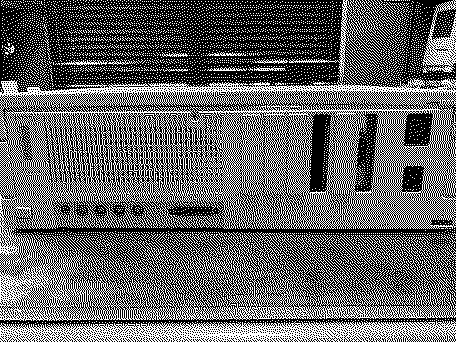

Not too bad. A view of the back revealed what looks to be a video card. Nice. For the other open slot, I have a spare Asante Ethernet card, so that will be filled in eventually.

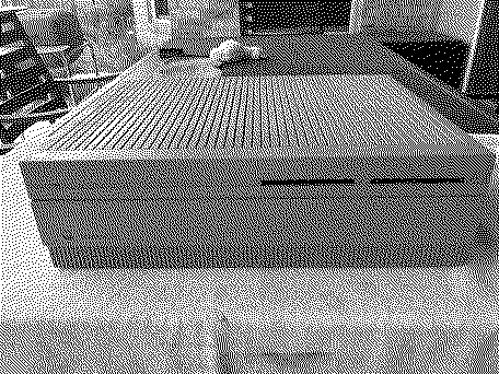

Other than a few minor cosmetic blemishes, the outer case looks to be in decent shape, perfect for restoration.

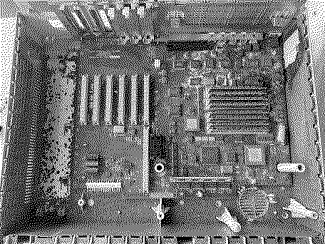

For $200, I wondered what horrors awaited me on the inside. Time to remove the lid and take a look.
Uh oh.

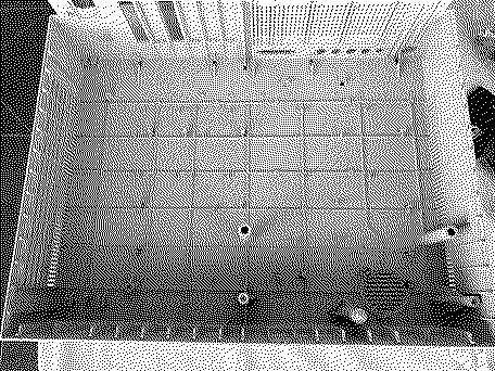

As you can see, there ares some bad signs. The black rectangular item sitting on the empty floppy drive bay near the bottom center is a piece of rusted, corroded metal from somewhere, and there are other pieces floating around that I could hear rattling when I gently shook the case. The second floppy port cover is resting in the bottom of the case near the power supply pins, and as you can see when you look in that area, rust is evident on the metal shielding. Same is true on the lid.
That big rust spot in the lower right corresponds with the back right of the IIfx, and if you are familiar with the layout of the IIfx logic board, you know what that means. Battery bomb.
Yeah. Battery bomb indeed. The left battery is a mess and the whole battery case lifted out easily when I grabbed it. The right battery is completely gone. Well, we can see where it went - all over the inside of the case. The metal shielding is a rusted mess, and by my look at the logic board, I judged it not worth repair. I decided to salvage what I could including saving the logic board in case someone decides to tackle a IIfx Reloaded board someday, in which case I'll donate the board to the cause. The rest I would chuck in the bin.

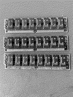

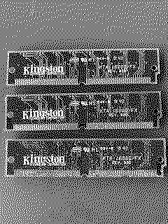

Next, I decided to tackle the RAM SIMMs to see how many I could salvage. The four 1-MB SIMMs furthest away from the battery bomb mess looked fine, so I set them aside for later testing. The four 4-MB SIMMs closest to the battery bomb mess were what worried me. Closer inspection of the front two SIMMs showed corrosion on the pins and on the two chips closest to the right, whereas the two SIMMs behind those looked fine. I wondered if I could restore the corroded SIMMs, so I went to work scraping and soldering and checking continuity. I also removed, cleaned, and reinstalled the two chips closest to the right edge. The following two photos show an unaffected SIMM on the top, a corroded SIMM on the bottom, and in the middle is the first restored SIMM. Not bad. I restored the second SIMM and set them aside for later testing.

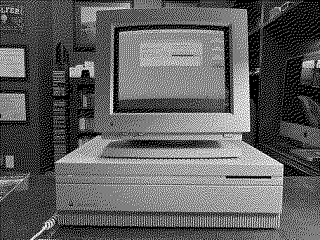

Next came the moment of truth. Would it chime and boot? I hooked up a monitor and a keyboard and mouse, plugged in everything, and held my breath as I hit the soft power key on the Apple II Extended keyboard.
No chime. Black screen. What?
Hmmm.
I verified everything was connected correctly, and tried again. Same thing. At least I could see the green power indicator on the power supply, and verified with my multimeter I was getting +12V on pin 1, +5V on pins 2-6, and -12V on pin 13. At least I knew the power supply was working properly. I pulled the speaker and measured for resistance, expecting to see 32 ohms. Aha, open circuit! Speaker is dead. I plugged in headphones and tried again. I heard the boot chime, followed by sad mac chimes. RAM issue, I surmised. I pulled the RAM, reseated them carefully and tried again. And....
Success! Boot chime through the headphones, no sad mac chimes, and a successful boot. I proceeded to run Snooper 2.0 overnight and encountered no problems. I even substituted the salvaged IIfx ROM SIMM and rescued RAM SIMMs, and all worked just fine - even the two RAM SIMMs I restored worked perfectly. Boot times are what I remember from 30+ years ago. Under System 6.0.8, the desktop is up in 5-6 seconds, almost before the monitor has warmed up completely. Under an enhanced System 7.1.1 (my preferred system for vintage Macs of this era, with a few add-ons as explained here), the boot times are way faster than the other vintage Macs in my collection, except for perhaps the overclocked Mystic Color Classic.
