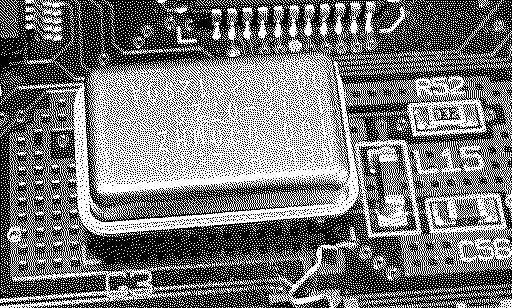

I replaced the crystal oscillator in my Macintosh IIfx from 80MHz to 100MHz, but there was no startup chime, and thinking I had broken it, I hurriedly reverted to the original, which then worked normally. Does simply swapping the crystal oscillator not work?
After removing the crystal oscillator, I installed a socket to allow the crystal oscillator to be freely replaced.
I was under the impression that it would operate at 68030/50MHz with this.
Is there anyone with experience?

As shown in the first image of the thread, I put a socket on it so that the crystal oscillator could be replaced, and installed a used 100Mhz crystal oscillator.
There's no startup sound. When I replaced it with an 80Mhz crystal oscillator, it started to start normally with the startup sound. It is unknown whether the crystal oscillator was the cause.
However, yesterday IIfx was given the next owner today, so I can't confirm it.
