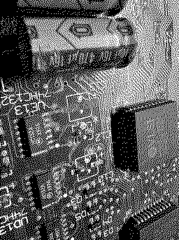

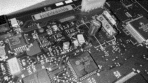

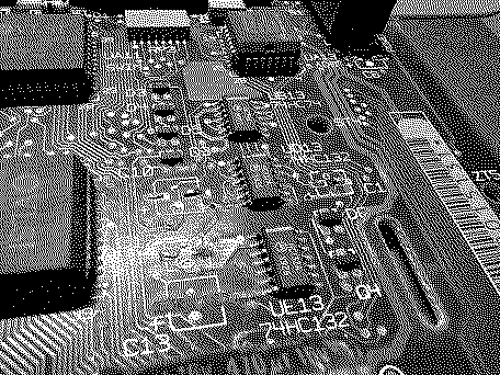

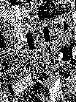

At this point I'd order replacement chips and transistors, they're pennies each.

That's fair. Is there a guide or list online somewhere for what modern replacements to use??

I would personally buy a hot air station -- they're pretty cheap nowadays, around $40 on Amazon. Then desolder the entire chip, clean underneath, and check for any open traces. Bodge wires are fortunately your only option to repair a broken trace, but you can route them on the underside of the board, if possible of course.

You're pretty close to getting the machine working -- I've already dealt with worse cap damage here.
