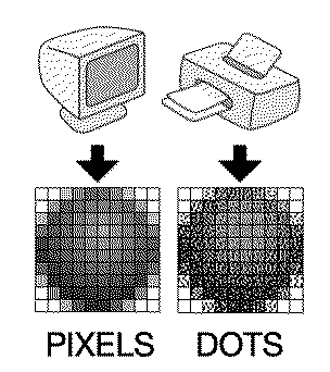

I also added code to automatically position the dock at the bottom center of the screen (before it was hard coded to bottom center of a compact mac screen. Heads up to future readers "resolution" meand dots per inch as far as Inside Macintosh terminology is concerned. So the ScreenSize function kept telling me 72, 72 and i thought hmmmmm sounds like dpi. Anyway i got the monitor resolution from the gDevice hbdle returned by GetMainScreen (primary monitor representation as a graphics device)
Liked by Patrickandretr01
Apr 28, 2023 - #15
Yeah. 72 ppi (pixels per inch) was the Apple standard screen resolution on Macs until soon after higher resolutions became available. :)
DPI refers to dots per inch for print.
