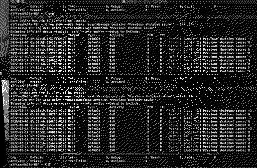

These are the shutdown causes it has logged.
...but I can't find any -2 causes listed anywhere. This is the best list of causes I have found so far. Anyone have some tips?
Screenshot 2022-02-14 at 18.11.45.png [View]

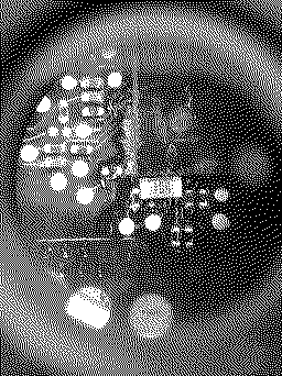

Things (Tinks?) are not going well... I took the MBP apart and found the SMC. After removing the goop it had in the corners I found a cap and a resistor that seemed to be somewhat loose so I figured "Ok, I'll just make sure they are properly soldered on"...
...Guys, NEVER do anything - ANYTHING - if your brain starts inserting words like "I'm just gonna..." at the start of the thought. NO! Bad brain!
... so now I am stuck with a broken 100K resistor the size of pencil dust, and a computer that definitely does NOT work. I had a 100K smc laying around but... well, it's HUGE!
I mean...
No. Just no.
So I started digging around about and I found an old MBP 2.33 from 2006 I'm going to take the 100K resistor from, if I can find one.... Anyone have the schematics for that one floating around? It's an 820-2059-A board. Also... hot air station ordered. I'm not going to muck about with an ordinary soldering iron for this. I just notice how unsteady my hands are that way.
12 - 2.jpeg [View]
