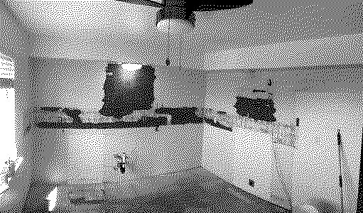

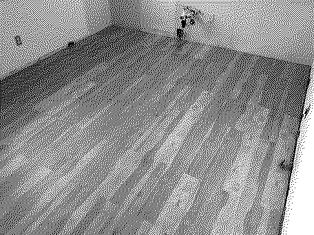

Wife wants a new kitchen, so I spent the past few weekends gutting out the kitchen to it's walls & sub floor. Getting all of our pots n pans, tools n do dads n dry storage was a chore in itself.
This floor was a heinous job that I wish on no other human. Such a PITA (&heavy). Breaking and removing and
Cleaning tile remnants is just yuck.
After the crap floor was removed down to the subfloor, I tackled the cabinetry, countertop and tile work. This went much faster comparatively and was easier work (less up n down than the floor).
I've put together our dining room as a temp makeshift kitchen off that 50w plug/extension dangling there. We are utilizing heavily disposable cutlery, plates etc through this process but any dishes made get done in bathtub.
Next steps are to clean up the Sheetrock and reseal it in preparation for texturing/tile work later on. I cando this is parts after work through the week leaving larger chores for the weekend. While removing the floor I realized it has shifted down by where the original heavy fridge location was maybe a 1/2-3/4 inch and am considering next steps to bring that true. I'm thinking of taking1/2" OBS and screwing/liquid nail that onto the subfloor to bring it up and reduce squeakiness prior to installing my new spalted maple water proof floor. Anyhow now I have a big stack of old janky cabinets & old appliances outside. I'm sure the neighbors love that lol
...and ol' murphy came knockin. While I was doing this demo and prep work, the O2 sensor on my truck went out so its in the shop and the mechanic wont be able to address it for a couple days at least, so hoping to get that addressed & fixed before the weekend. More to come.

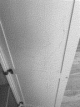

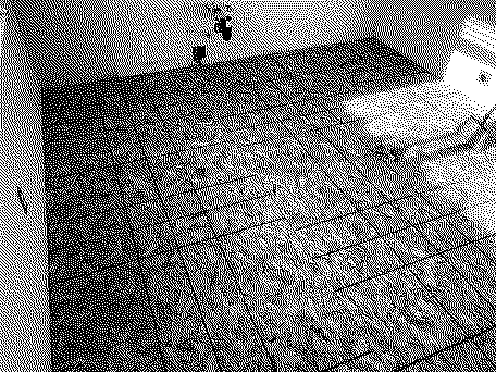

Another productive Saturday spent on my knees. Dropped the new OSB subfloor. I ended up shimming under where the original subfloor had sunken down - came out very well and sets me up for a clean transition from dining room to kitchen when I drop the final floor tomorrow. The 500+ screws that went in to secure the OBS, now that part got old pretty fast but needed to be done to prevent squeaks n humps.
Also ran about 20 feet of stainless steel water hose under the subfloors to where the new fridge will live and popped it out of the wall. I still need to find a nice box to finish off the hole I cut into the sheet rock. Luckily I only had to drill through one support beam and the 2x4 bases of each wall as I came up through the floor - not too bad all in all.
Also cut out some segments of hole-E sheet rock and patched them up and sealed the exposed Sheetrock sections in preparation for installing the tile back splash (last step).
Anyhow, it's coming along. The floor has been a real bear - so much work has gone into just getting it to this point lol.
On a positive note, the mechanics Fixed my truck so I was able to drag all the old cabinetry n bits I yanked off last week to the dump this morning.

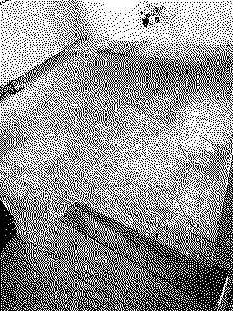

Mar 21, 2022 - #6

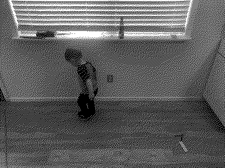

Finished the floor. I am done with floors for a while - not a fan lol. Transition into the kitchen went well. Cutting out the vent was a pita but got it done.
I am sore and am very glad this stage is over.

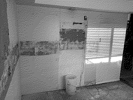

Apr 24, 2022 - #10
Got the uppers hung & I realized quickly how not square the kitchen soffit is when trying to hang square cabinetry in it lol. Anyhow got it done.
It has been an absolute struggle to get the butcher block counter wood in. Paid for but the supply chain for it is all screwed up and has taken forever to get it here. Hopefully we can get it installed by end of next week. My new dishwasher, sink & disposal have been on my back porch waiting for the stupid counter to get in. It's always something dragging out the schedule but Dems da breaks with any project I suppose. Anyhow below is a pano with everything in except an 18x90" pantry that I will install next to the fridge at some point.
For now though, really just waiting on that Butcher block counter top and then onto the sink, remaining appliances and then finishing touches like backsplash tile, hood, & touch up painting - after that, I'm walk-in away :)

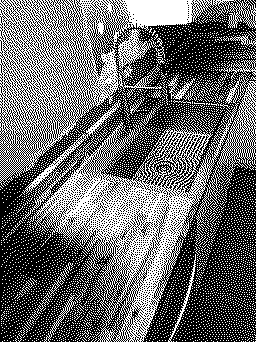

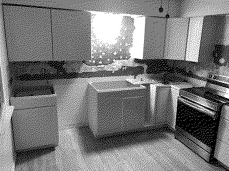

May 10, 2022 - #11

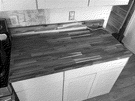

Finally got ... half of my butcher block counter in lol. To add to the humor of it all & absolute time suck, the company we purchased through ordered the wrong amount (they measured!!) so I have half of my counter in lol. Got the dishwasher installed (who knew you had to have it professionally installed to maintain full warranty & install ppl won't install without counter so... took a minute) otherwise I would have installed myself about a month ago lol. Anyhow, coming along - can finally see it coming together.
Got the doors that needed flipping, flipped & shelving in. I am especially happy with the Kohler basin sink & faucet. That setup is slick, easy to install & had absolutely all the bits n bobs. Also installed the usb charging plugs & a new low profile garbage disposal, so that but is done. Below is the naked bits still needing acounter.
I installed an additional pantry next to the fridge for added storage and am considering what I'll install over the top. I was thinking one of those wall/ceiling mounted wine cooler perhaps. Wife & I enjoy our vino, so I think that would be a nice & well used addition/upgrade. Next is to install a box hood and to pick out what tile we'll go with for the back splash.
Finally got the contractor to sign off on the work.

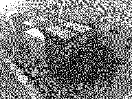

May 15, 2022 - #13

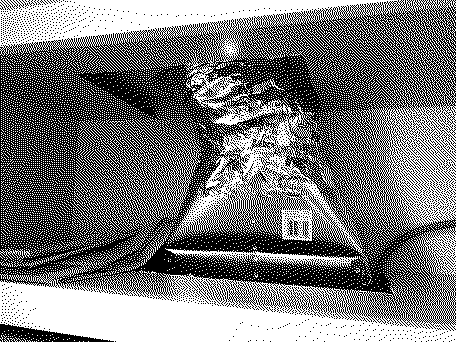

We have the same faucet here at our place. Just a heads up about it... Sometimes, it will dribble out the spray holes, instead of just using the aerator. If I depress on the switch that goes between the two modes, it will usually stop dribbling for a bit. Sometimes helps to also depress the high water flow button (the one above the switch).

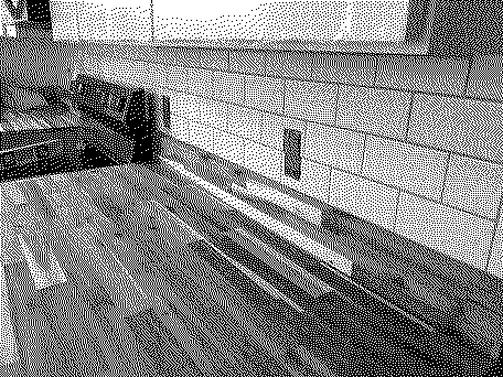

Jun 26, 2022 - #16

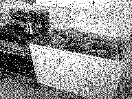

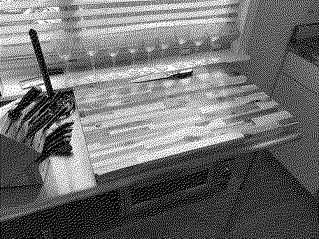

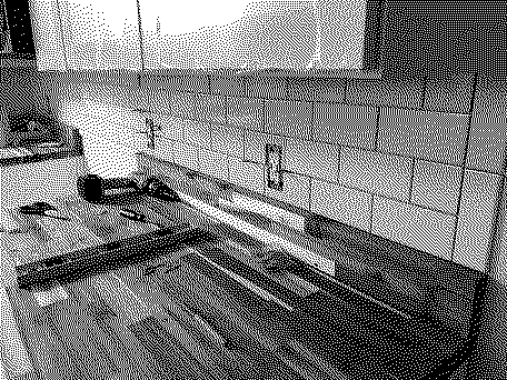

Finally got to the subway tile backsplash. This isn't a terribly bad job but is slow going and very easy to make a huge mess, so having tarps taped off and all your meez in place is key to completing each section with relative speed and cleanly. In the past I've used tile adhesive that you trowel onto the surface or back butter tough to fit pieces but this time I used a new product called muscle bound. It's like super sticky adhesive double sided tape for tile. I had some issues with it not adhering to the Sheetrock in places because when I was oiling and conditioning my butcher block counters, some of that oily residue remained on the Sheetrock, so what they say is true - the surfaces your adhering to have to be 110% free of residue/dirt. Once I got those spaces I missed cleaned it worked ok. Still, I wasn't entirely sold but overall it worked well enough. Below are my subway tiles adhered to the musclebound mat ungrouted.
Where this stuff gets kind of hard to use and inconsistent is around sockets. In the pic above you can see where I reaffirmed the cut tile pieces around the sockets with liquid nails because they did not adhere solidly on their own. This was a big disappointment and why I would think twice before using it for this application again. None the less, overall, adhesion was good so I proceeded to grout. Better half wanted a cool gray grout w/ flake (pure steel) so I settled on a premix Mapei flex color 3D grout. About $50 bucks per half
Gallon but worth not having to muck around with mixing up your grout and has a resealable lid so will not dry out as you progress through a multi-day/weekend project like this. So, as of right now, I got the east backsplash wall completed so cooking can recommence (had to pull out stove to tile & grout behind.
Most importantly wifey is very happy with the look and the flake in the grout has made my hands looks like sparkly magic elf hands.

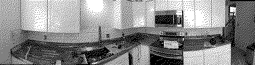

Hey @Certificate of Excellence, is it just me or is your new kitchen suddenly curved? o_O:D
The panorama feature on the phone can be a pain, I know! :D
