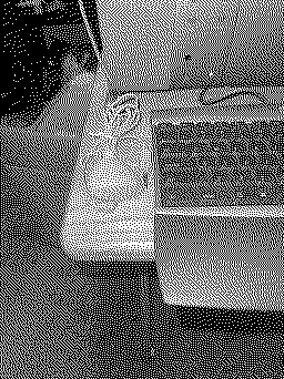

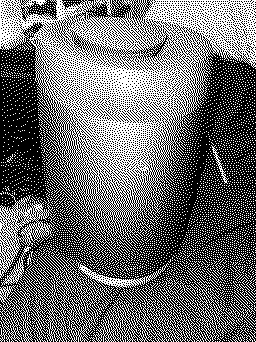

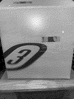

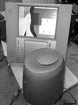

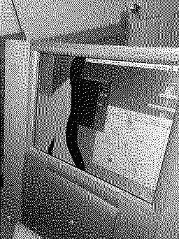

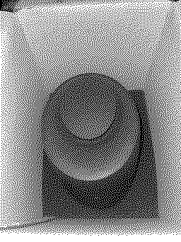

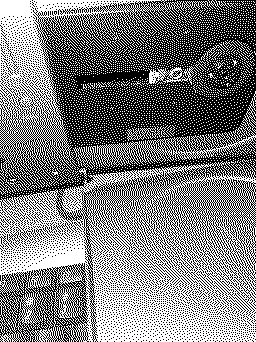

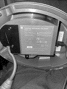

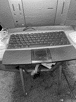

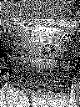

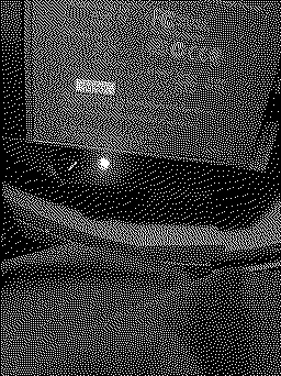

Hello everyone I very excitedly picked up a TAM (finally) it powers on and includes everything. There are some scratches here and there but that's easy to fix, what really scares me is finding a new LCD this one as you can see is half working it obviously needs replacing. Does anyone know a compatible LCD to put into this machine? Also yes the CD tray is broken but again another very easy fix. All in all I got this unit very cheap (as far as a TAM goes) and I'm excited to get to work on it. It should be coming to me in the coming days. I have pictures below and any comments, feedback, or tips are greatly appreciated.

I am sure you can replace the LCD as it is likely the same in one of the PowerBooks.

Yeah I saw that guide but no LCD link sadly.
Aug 26, 2022 - #5
Chin up, @jajan547. It's the LCD screen from PB 3400 and PB G3 Kanga models. :)
TAM Twentieth Anniversary Macintosh LCD replacement
Found one for sale with a rotten LCD. Powers up and just needed a replacement LCD. I doubt I can get a replacement easily, are there any compatible replacement available out there?

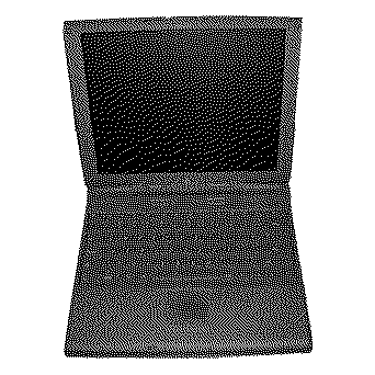

Would this work to replace the LCD or is it the wrong G3 model? (not really familiar with apple portables as you can tell)
Aug 30, 2022 - #13
>> jajan547 said:
Would this work to replace the LCD or is it the wrong G3 model? (not really familiar with apple portables as you can tell) Click to expand...
No. PowerBook G3 Kanga looks like this:
