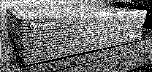

Recently I ran across a couple SGI machines for sale, and despite the fact I really don't need them, and don't have a compatible monitor, I went ahead and bought them. I always marveled at SGIs as a kid in the early 90s, but of course saying they were cost-prohibitive is an understatement. 20+ years ago I had a couple and tinkered with them briefly, but did not own them long before I sold them.
One of the new machines is an Indigo with I believe a R4400 and XS24 graphics. The PRAM battery is dead so we were stuck at the low battery warning and could not check hinv to confirm the processor, but I did pull the graphics board and confirm it is XS24. The other is an Indigo2 with a 175mhz R10000 and Solid Impact graphics. I also got a Indigo-compatible granite serial keyboard and beige mouse, and matching purple stands for the Indigo2.
Other than replacing the Indigo PRAM battery, are there any maintenance tasks that need to be done to these machines? They sat for the last 20 years or so. I have heard the PSUs generally need to be recapped, are there any other caps that are prone to leakage?
[Image: Indigo.jpg][Image: Indigo2.jpg]

I'm not very familiar with the original Indigo, but I just restored an Indigo2 very similar to yours: https://oldvcr.blogspot.com/2025/09/refurb-weekend-silicon-graphics-indigo.html
The Indigo2 is pretty tough. The power supplies do die, but recapping them needs to be done on the high-voltage side, so it's not a novice task. Unfortunately no one has come up with an ATX conversion kit for these like there is for the Fuel. I also replaced the DS1286 in it, but this isn't as critical as doing so is with, say, the Indy.
Good call on the stands - you shouldn't run the Indigo2 on its side without them. I'm also assuming you have a display which can handle SGI 13W3 and sync-on-green.
