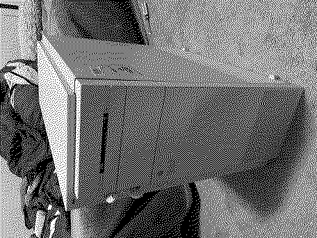

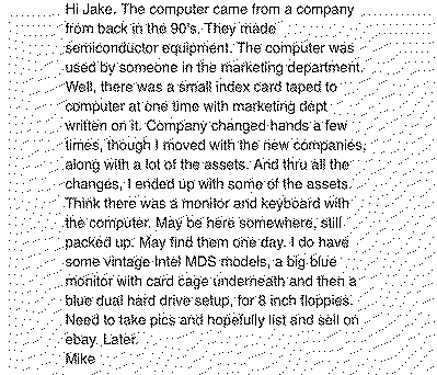

So my Quadra 950 arrived yellowed and missing the blanked out bezel. This I thought was my only issue but it later appeared that the clips and screw post on the original side panel had been broken off with a mix of shipping and age related damage. This bothered me greatly, the yellowing I knew I could fix (and while the end result below isn't perfect, I'm happy with it) but the missing bezel and damaged side panel I knew would be difficult. Thanks to @360alaska I was able to modify his existing CD-ROM bezel to make a sort of blanked out bezel with strange protruding rectangles. This was later fixed with my updated revision which is flush and posted here as well as the first revision in the 3D printing section and I've also included @360alaska's original models as well for convenience sake. Eventually through a seller somehow within four hours of me I was able to track down a new side panel and blank bezel, they weren't cheap but I figured this machine deserved to be pretty again. I then removed most of the yellowing, popped in the panels, and well the rest is history. Out of curiosity I reached out to the the seller I bought this Quadra 950 from and asked him some history about it if he knew about it, and to say the least it's been through some environments and paths (I've included a screenshot of what he told me about it below as well). Pictures are below and the machine works great.

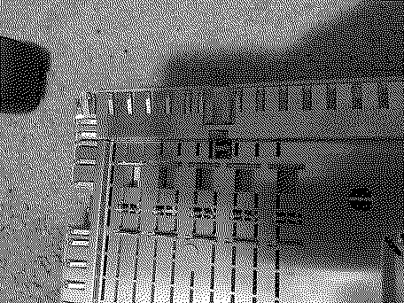

Oct 28, 2022 - #20
I still need all the parts i listed originally Click to expand...
Looks like I allready donated parts ... so the floppy drive and psu what is left
