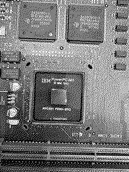

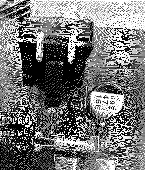

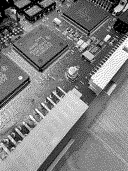

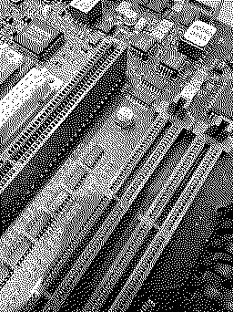

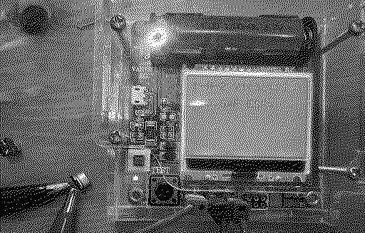

Can you get a good quality picture of the logic board on its own, with nothing connected or plugged in to it?
V.Yakob
Syktyvkar
Joined: Sep 6, 2023
Posts: 129
Likes: 46

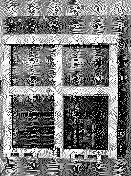

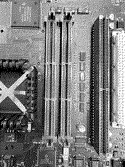

Feb 27, 2024 - #7
@Kai Robinson, Of course. I took the board out of the body.
Near some capacitors I see strange white traces, and like dust on the contacts, but it is not washed. At first I thought there was a leak, but it doesn't look like it.
[Image: IMG_1382.jpeg][Image: IMG_1383.jpeg][Image: IMG_1381.jpeg]
Otherwise, except for some strange soldering on the board, I don't see any problems: The cache and ROM slots look normal, the stick ROM looks normal.
IMG_1382.jpeg [View]
IMG_1383.jpeg [View]
IMG_1381.jpeg [View]
Feb 27, 2024 - #8
That's corrosion - you'll need to recap that board - the 'dust' is corrosive gunk from the capacitors for sure. Just because there's no visible signs doesn't mean the board hasn't been subject to it. All the solder joints on those caps are dull.
Liked by V.Yakob

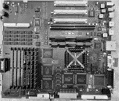

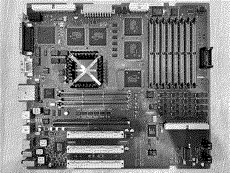

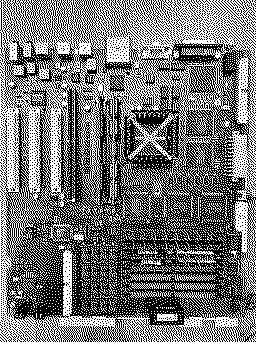

Apr 7, 2024 - #19

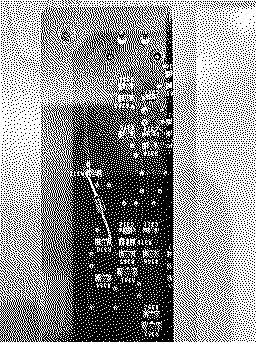

And so, time went by and I finally received a parcel with a different motherboard, as I understand a newer revision than it was.
This board was stored under normal conditions because I don't see any obvious signs of corrosion.
I installed this board, and everything seems to be working properly.
Moreover, the nubus ports apparently did not work on the old board, I have one SuperMac Thunder/24 video card that did not work there and was not even detected. Maybe there are some other malfunctions in that board or I overheated something with a soldering iron.
It works here.
Just in case, I'll leave photos of these motherboards here for history. Apparently, newer revisions of chips are used on the new board, because in general they do not seem to differ.
PM8100-80.820-0557-B (New).jpeg (2.8 MB)
PM8100-80.820-0473-G (Old).jpeg (2.9 MB)
