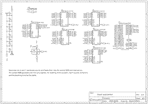

Old project, wondering where it has gone. Full feature set here.
Features
  • CRT and LCD display support
    • 24bit Standard VGA interface
    • Separate VSYNC/HSYNC and combined CSYNC synchronization signals
    • Composite BLANK signal
    • TripleDisplay support
  • 12bit Interface
    • Compatible with DVI transmitters and 12bit VGA ADCs
    • 4 different output modes
    • Can be used simultaneous with the 24bit interface
  • User programmable video resolutions
  • User programmable video timing
  • User programmable video control signals polarization levels
  • 32bpp, 24bpp and 16bpp color modes
  • 8bit gray-scale and 8bit pseudo-color modes
  • Supports video- and/or color-lookup-table bankswitching during vertical retrace
  • Flexible master and slave interfaces
  • Operates from a wide range of input clock frequencies
  • Static synchronous design
_______________________________________________________________________________________________________
Clarification of question above? *****
Could something like this be run from VGA input to output 8bit GS mode signals to A/B of SE/30 or the GS harness? Could the blanking periods be adjusted in real time? Dropping HDMI video frequency from 60Hz to 30Hz seems to be a thing. Might that roughly equate to dropping every other frame of IIsi video output if real time conversion can't be attained?
***** Further muddled? I think schematic and spec pages go together? Not at all familiar with GitHub cross referencing. They seem to be linked in my duckduckgo hits?

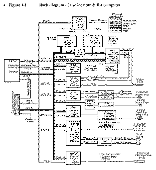

Looks like we might keep it digital on a IIsi board reload for SE/30?
The video signals are generated by the Apple custom RAM-Based
Video (RBV) chip and are driven through a combination color
lookup table (CLUT) and video digital to analog converter (VDAC)
chip. Each monitor identifies itself by grounding certain pins on the
RBV causing it to automatically select the appropriate pixel clock and
sync timing parameters.
Dunno how Sync Sign works, but bits 0-8 of Video output from RBV Might be hijacked and VDAC removed from the schematic? No need for CLUT in a dedicated B&W or grayscale system, no? RBV is the Achilles heel of current efforts over at the MLA. If something like the circuit above can be wedged into the Block Diagram of the IIsi in place of VDAC. we might get there? Might we adjust the blanking period of 12" RGB output in real time at that juncture in real time?
If not possible, redrawing "every other frame" on the CRT a second time whilst adjusting the blanking periods of the next "other frame" is accomplished would halve the actual frame rate, but might be fine in grayscale for everything but demanding gaming?
edit: wouldn't need to excise VDAC so much as to just ignore it? Assumption would be that Address/Data on left side of VDAC only relates to CLUT?
1742598619574.png [View]

Mar 22, 2025 - #6
>> Trash80toG4 said:
Looks like we might keep it digital on a IIsi board reload for SE/30? <SNIP> Dunno how Sync Sign works, but bits 0-8 of Video output from RBV Might be hijacked and VDAC removed from the schematic? No need for CLUT in a dedicated B&W or grayscale system, no? RBV is the Achilles heel of current efforts over at the MLA. If something like the circuit above can be wedged into the Block Diagram of the IIsi in place of VDAC. we might get there? Might we adjust the blanking period of 12" RGB output in real time at that juncture in real time? If not possible, redrawing "every other frame" on the CRT a second time whilst adjusting the blanking periods of the next "other frame" is accomplished would halve the actual frame rate, but might be fine in grayscale for everything but demanding gaming? Click to expand...
I mean, if you can reverse engineer and/or bypass the right components, you can pretty much do whatever you want once you have the raw pixel data and use whatever timings you like. That's the easy part in the digital domain. You can spit out DVI/HDMI for that matter. This gets into the space of the sort of RGB/HDMI mods that vintage game consoles do. Not something I have experience with myself, but it's doable. But replacing the whole RBV might be overkill if it's enough to hijack the digital data coming off the RBV and reclock it yourself on the back end. Might be easier that way as well. But the foundations of what you are trying to do are basically the same as any digital output mod for something like an NES/SNES or the like. Just you want to produce an analog signal on the back end still, which itself is quite doable. This just might require some software running on a microcontroller of some kind, and be fast enough to keep up with the signals being flung around.
I still believe that thinking in terms of reducing refresh rate to make the problem simpler is not the right way here though. Consider how folks have built upscalers/etc that take in composite/VGA/etc and can spit out anything from frame rates in sync with the input signal, or even very specific frame rates like 60Hz HDMI. These are absolutely capable of spitting out different pixel clocks on the other end and using different approaches to minimizing latency, and how to deal with inputs that are slightly faster/slower than the intended output. In your case, you actually have it a bit easier since CRTs are a bit more flexible than a modern display, and so you don't have to worry as much about refresh rates being exact.
The trick here is that you ultimately have data coming in at one pixel clock, and you want it going out at a faster pixel clock so you can add a longer back porch to it (assuming same number of lines, same refresh rate, you need to spit out more pixels in the same timeframe even if the extra pixels are just black). So the simplest way is to buffer some of the data, and spit it out in some well-defined chunk. Buffering by the line is the easiest here, as you can capture just the active pixels in the buffer, and setup the exact line timings you want for the output. Buffering a line just means you don't start sending the line to the SE/30 monitor until you've read in a whole line from the logic board's circuit. So that adds some amount of latency, but not enough for anyone to notice. It's still "real-time" for the purposes here.
