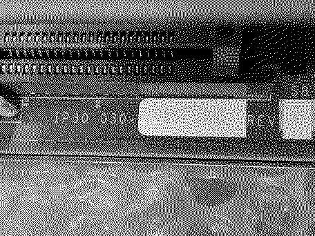

And the part number of the new system board:
[Image: IMG_6721.jpeg]

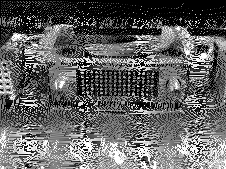

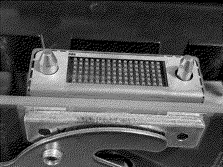

Here's one of the compression connectors from two angles:
[Image: IMG_6716.jpeg][Image: IMG_6719.jpeg]

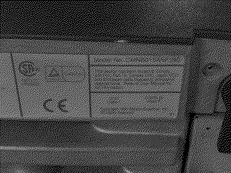

And the other:
[Image: IMG_6717.jpeg][Image: IMG_6720.jpeg]
And how these compression connectors work is beyond me... I'm just a geek that enjoys exploring old computers. [nerd-face]

From a quick look, it don't see why that board wouldn't work, unless it needs a different backplane version.
Are you able to swap over just the CPU module from the new board to the working board? If you have pics of both boards it might help.

I believe the system board seller failed to adequately protect the compression connectors, and one/both were damaged in shipping. They were, after all, protected by pieces of paper. [face-palm][male-sign]
