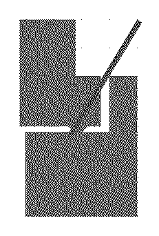

Also, the joint isn't usually in line with the faces but actually inside a groove, that's called a shear joint (thanks Wikipedia), which means we might need to go at an angle:
[Image: 1761396776356.png]

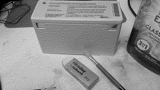

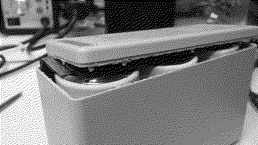

Here on this Macintosh Portable Rechargeable Battery we can clearly see the melted joint on the bottom left of the seam.
[Image: MacintoshPortable_Battery_20251022_170808.jpg]

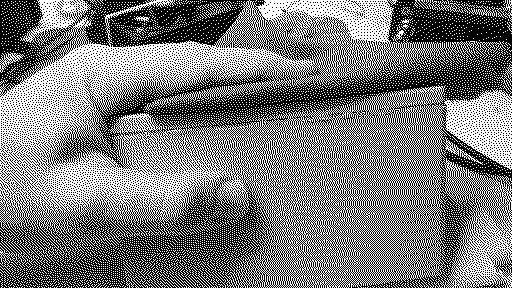

What we need here is to direct the force to a localized area of the plastic, just like they did with the sound. So we use a blade, but a very narrow one, so the impact doesn't spread to a chunk of plastic, which means putting more force into it to break it apart, but instead cut into small sections one at a time.
I initially tried with 1cm wide blades, and though it did work, I had to hit quite hard, and I managed to knock out some coils inside the power supply I was opening, breaking their leads. Because the force was transferred to them and they vibrate mechanically. That's why you see glue on these large components, to limit vibrations that could damage them (indeed, only those which didn't have glue broke).
So I found narrower blades, 2mm wide, and now it works every time, almost perfectly. Unless you get distracted and hit elsewhere. See at the end for the link.

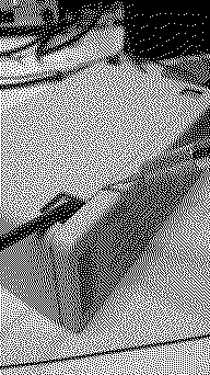

Find the joint inside the seam, and target it at an angle with the blade. Start at a place where it's visible, like contacts or connector holes.
[Image: MacintoshPortable_Battery_20251022_171048.jpg]

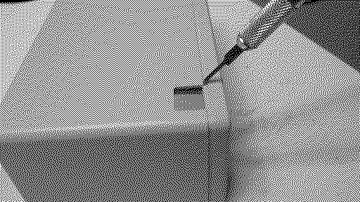

Tap the other end of the exoknife with the rubber mallet to puncture the joint. Then move the blade a few millimeters further along the joint, hit again.

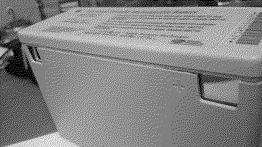

[Image: MacintoshPortable_Battery_20251022_171305.jpg]

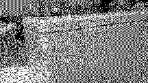

Eventually you'll reach a point where you can use lever or prying tool to start to separate the parts and see the joint better.

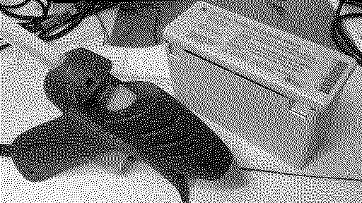

[Image: MacintoshPortable_Battery_20251022_171511.jpg]
Continue along the other seams, making sure you stay on the right side (it's not always the same).
