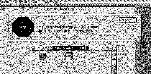

Anyone have any tips on how to get a complete install, with applications, on my internal hard drive? I was able to finally get my keyboard fully working, and would not like to get a good setup of LOS 3.1 and MacWorks XL on it with a variety of apps. Thanks!
BTW, this is the error I receive (replicated in LisaEm while trying to build a HD image more easily on the emulator and then trying to transfer to the Cameo/Aphid:

I know the process is you highlight the app and stationary on the install disk and make a "duplicate" from the menu, and then drag the copies to the hard drive. That's when the master floppy gets serialized to the specific Lisa.
If you are just trying to drag the apps straight from the diskette to the HD, I can imagine this is what would happen...
Hope that helps, and my recollection is still good!

I know the process is you highlight the app and stationary on the install disk and make a "duplicate" from the menu, and then drag the copies to the hard drive. That's when the master floppy gets serialized to the specific Lisa. If you are just trying to drag the apps straight from the diskette to the HD, I can imagine this is what would happen... Hope that helps, and my recollection is still good! Click to expand...
^^^ This is the solution! ^^^
Ah, that is the trick! I had no idea you couldn't just "copy" (which I believe in LOS is actually a move) an app off the floppy. So you are correct, the proper way to install an app from a floppy disk (real or emulated) is to select the application, press Command-D (or select Duplicate from the File menu). You will be greeted with a blinking "duplicate" of the original, which you can drag to your hard drive of choice. At that time, it will ask you if you want to serialize the copy of the software. That means that floppy can only then be used for running / installing on the Lisa with your serial number. Early piracy prevention at its finest!
Thank you so much for that awesome suggestion! I now have the entire suite of Lisa software on my hard drive and can remove the ridiculously long floppy cable running out the back of the Lisa!
