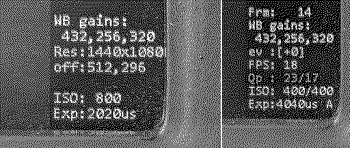

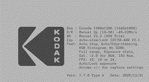

Version 7.7 for Type A, B and C (and stock FW recovery for D users.) So nothing for Type D yet, at least now unit can be recovered if the wrong firmware is installed.
New to v7.7
- stats and controllable field are written off the video image (bottom right corner.)
- there is now an ISO Max control, supporting 100,200 & 400 ISO settings. Defaults to 100.

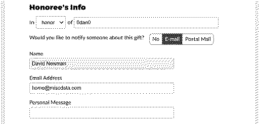

Donations:
This project of reverse engineering a consumer product is in the grey area legally, but it shouldn't be. We own this hardware, we should be free to modify it as we want, and share those modifications without any concern. A charity that I donate to every year, Electronic Frontier Foundation (EFF), deals with customer rights like these. So if you want support projects like this one, please donate to the EFF.
You can thank me in your donation via:
https://supporters.eff.org/donate/tribute
Use this contact info.
