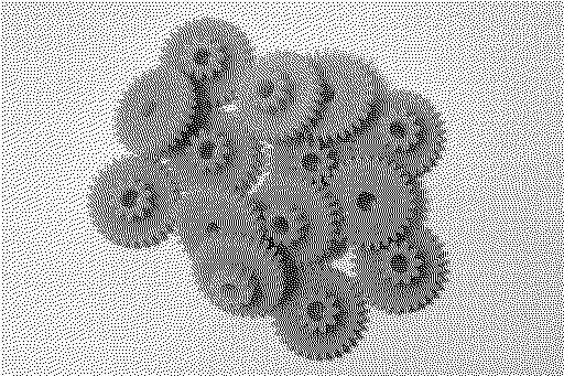

I printed off about 40 Macintosh floppy gears in the resin printer, The design is the latest V2 from the amazing Stephen:
https://www.thingiverse.com/thing:4167139
Some of them still require removal of rough bottom edges from the print bed.
If you are in need of a few let me know and I will send them out for cost of postage!
DSCF0669.JPG [View]

They look really good!
Oct 26, 2021 - #3
@Drake These do look good! What sort of support and angle setup did you use for these?

Oct 26, 2021 - #4
>> Elemenoh said:
@Drake These do look good! What sort of support and angle setup did you use for these? Click to expand...
no supports, nothing special going on. Just printed right on the bed and knocked off afterward
Oct 26, 2021 - #5
no supports, nothing special going on. Just printed right on the bed and knocked off afterward Click to expand...
Huh, I'm surprised you didn't have a problem with elephants foot. Did you shorten the exposure time for the initial layers compared to a typical print?

Oct 26, 2021 - #6
>> Elemenoh said:
Huh, I'm surprised you didn't have a problem with elephants foot. Did you shorten the exposure time for the initial layers compared to a typical print? Click to expand...
basic settings for mars pro 2 in chitubox, lifting speed set to 30-40mm/sec

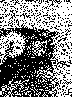

@Drake would you mind sharing some screens of your print/advanced settings from chitu - trying to get these to print on my Mars 3 and just got a bunch of elephants foot if i print directly on the bed, and some sagging requiring sanding the bottom if i use supports.
Are you using any kind of exposure compensation at all?

>> mitchkramez said:
@Drake would you mind sharing some screens of your print/advanced settings from chitu - trying to get these to print on my Mars 3 and just got a bunch of elephants foot if i print directly on the bed, and some sagging requiring sanding the bottom if i use supports. Are you using any kind of exposure compensation at all? Click to expand...
Filebin | ufxhp2j94qgqa2nr
Convenient file sharing. Think of it as Pastebin for files. Registration is not required. Large files are supported.
[Image: filebin.net] filebin.net
pre-sliced for my Mars 2 pro, it should work on the 3 (couple chitubox versions behind).
Ensure you use a tough resin and cure immediately (I use a UV curing box). I've run these off with cheaper resin but the teeth NEED resin with better rigidity.

Jul 20, 2022 - #13
Ah! They are on supports there, that makes more sense. thanks for posting that! Hoping to get some printed in the ABS grey elegoo resin!

Jul 21, 2022 - #14
@Drake - Using yours as a basis for the angle, I took the original, and adjusted the supports to be no wider than the gear teeth, and also lowered the support penetration so they have zero impact on the gear teeth themselves. They now very easily unzip from the supports and require almost no post processing or cleanup. Each support was carefully positioned to be just inside the edge of the gear.
I did notice that mine are printing to be about ~3.93mm tall from base to top, and the originals were ~3.63, but a couple of quick passes on some 180 grit sandpaper and a quick bath made easy work of that, and after installing them - they sound and work great. Did about 100 eject cycles and inspected the gear and it still was looking perfect!
Here's the newly supported file should anyone want it. If you'd like the .chitubox project so you can move the supports for any reason, just let me know!
