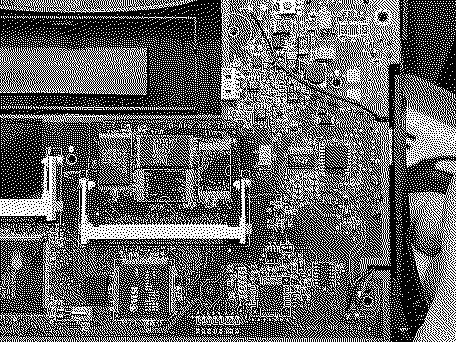

Here's the side of the board that's exposed when the bottom is taken off. I'll need to desolder the speaker and backlight wires again to get the board out.

C120 and C194 and the other obstructed by the cable check those caps on almost all Hard drives manufactured by Apple that has had those I've had those fail.

May 15, 2022 - #7
>> Stephen said:
There's no ROM board present. Click to expand...
LOL I missed that ^^^^ he's right.

May 15, 2022 - #8
>> jajan547 said:
LOL I missed that ^^^^ he's right. Click to expand...
Nah, that's the expansion slot that's empty. It's typically empty (expansions are sort of rare).
The ROM is present but "camouflages" in with the rest of the board ... if you're not looking closely enough like me!

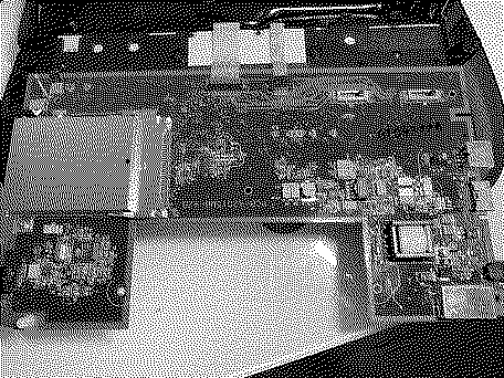

OK. I'll check those out. I've attached an unobstructed view plus two shots of the other side of the board.

May 15, 2022 - #11
>> charkes said:
OK. I'll check those out. I've attached an unobstructed view plus two shots of the other side of the board. Click to expand...
C93 should be replaced most likely leaked
Posts: 668
May 15, 2022 - #12
The eMate is from 1997 - I find it unlikely that that capacitor would have leaked. Replacing it is a good place to start, but I doubt it will end up fixing whatever issue you have.

May 16, 2022 - #13
Is the junk near C93 an indicator of a leaky cap? I understand that there's flux on the big connectors for the transformer next to it.

May 16, 2022 - #14
That's flux
Liked by charkes
Posts: 668
May 16, 2022 - #15
The junk looks to just be flux to me - the pads on the capacitor look perfect and aren't corroded. If the crap on that board was all electrolyte, I'd expect some corrosion on the cap pads. If you want to replace it, go ahead. It will only extend the life of the eMate, but I don't think it's the cause of your current issue.
