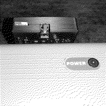

First order of business, change the power supply before I attempt repairs.
I got this:
C64 PSU, C64 Power Supply, Commodore 64 PSU, Commodore 64 Power Supply, Commodore 128, Amiga 500, Atari, ZX Spectrum
C64 PSU, C64 Power Supply, C64 power pinout, C64 power connector, Commodore 64 PSU, Commodore 64 Power Supply, Commodore 128, C128 PSU, Amiga 500, Atari, ZX Spectrum
www.keelog.com
Commodore 64 FDD Dual Power Supply (C64 FDD Dual PSU)
To my surprise, not only the voltage was received well inside my C64 but...the machine...worked? I thought it was dead! Same goes for my monitor! I thought I had cooked some chips during a lengthy 2016 gaming session when I showed many games to a friend visiting us, I was starting to get random garbled letters on screen, the disk drive would no longer respond well, etc. I didn't investigate at the time, thinking I'd have to do a painful investigation using Adrian Black's videos as a guide.

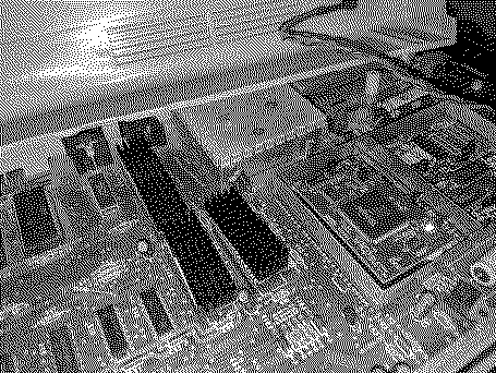

My working C64 is a 1983ish breadbin ASSY 326298, so it had an annoying metal shield cage around the VIC chip, but once you work your way with a flathead screwdriver to bend out the pins on the left short side of the cage, the rest follows up well. Some advise to desolder a few tabs so that you can remove the cage walls as well so that it makes for an easier removal of the socketed VIC chip, but I was too impatient and I'm extra careful with my chip leveraging.
so the old NTSC VIC chip I had was a 6567R56A
out with the old, in with the new, I got the Kawari VIC-II mini seen here, with a TRION FPGA. I also made these light changes:
-install 3 aluminium heat sinks over my SID chip (GOD they become hot under use), 4 over my CPU and 3 on the chip besides the SID, I think it's the PLA? Might be wrong on that.
-Clip off the RF shield underneath the motherboard and chucked it out along with its cardboard insulator sheet.
