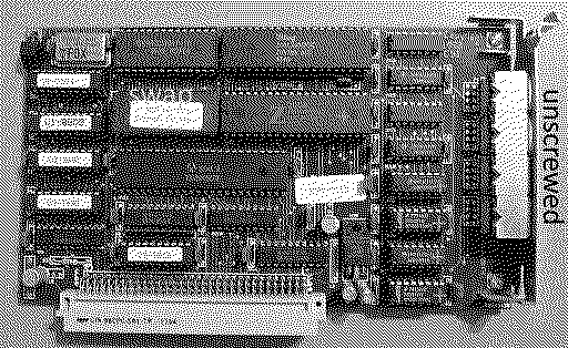

I recently acquired a CSI Hurdler II NuBus card that adds serial ports to the Macintosh. Using the card and upgrading it sent me down a rabbit hole.
When I received it, the CSI Hurdler indicated that it was a "dual" (HDS) serial port card, although it had all four ports soldered in place, along with some empty DIP sockets. Based on the existing chips, I guessed that it was missing an additional Zilog Z8530A SCC, (2) AM26LS32 line receivers, and (2) AM26LS30 line drivers. So, I added those. Unfortunately, that did not result in immediately converting the card to a "quad" serial port card.
I then reached out to @Byte Knight , who runs the Captain's Quarters II BBS with a quad (HQS) CSI Hurdler. He immediately sent me a copy of the ROM. (Thank you!!). Burning and installing the quad ROM indeed successfully finished the conversion of the dual card to a quad card.

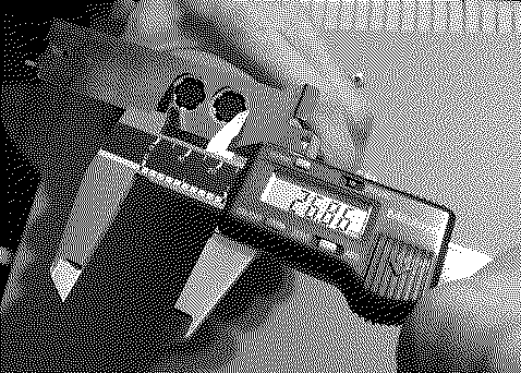

The rear slot cover of the card only exposes two of the four serial ports. I simply unscrewed and removed the slot cover to access all four ports. However, I am considering drilling the other holes.

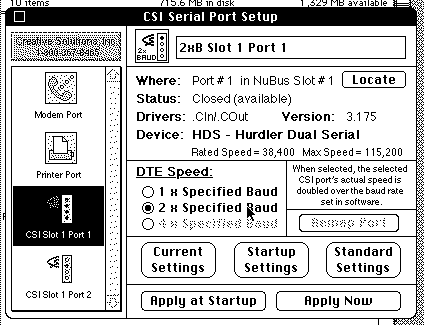

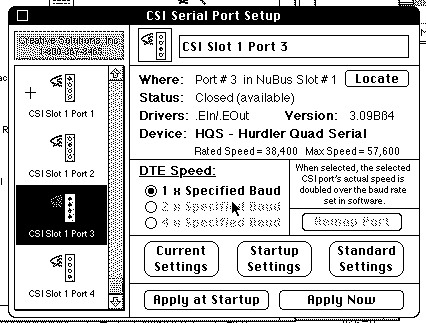

One of the nice features of the CSI Hurdler II is that it can double or quadruple the baud / bit rate that the application chooses. For example, if your terminal program is set for 57600, the CSI can secretly set itself for 115200 or 230400. These values were not originally supported by the Macintosh System Software and thus aren't listed in old terminal programs. CSI notes that many baud rates don't double nicely. For example, 38400 doubles to 76800 -- which is not a standard rate. Watch out for that.
With the Dual ROM installed, my CSI card offers the 2x option, but not the 4x option.
With the Quad ROM installed, my CSI card does not offer any speed increase.
This could be a limitation in the ROM, as my Dual ROM is a newer version. Or, it could be that the card itself is not fast enough to service the four ports at double speed. It turns out that CSI had two faster cards, the CSI Hustler and the CSI Lightening. These cards were capable of the faster speeds. I have not been able to locate either of these cards for purchase.

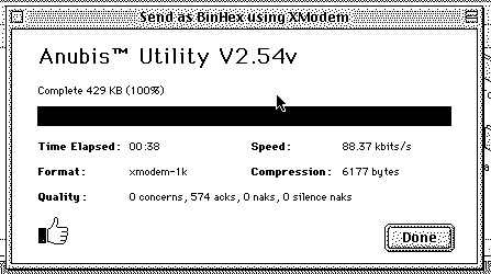

I successfully got my software to run at 115200 on a Power Macintosh G3 connected to Basilisk II. But, even though the drivers did not return an error, I could not get it to talk at all at 230400. I tried using a different USB-to-serial cable without luck. Eventually, I connected a Power Macintosh 4400 to another Power Macintosh 4400, which ran successfully at 230400. So, I believe there is a 230400 baud bug or limitation in Basilisk II.
In the screenshot below, I got 4x the throughput on a Power Macintosh 4400 at 230400. The reason the speed only lists 88.37 kb/s, is that BinHex adds bloat and XModem doesn't have a sliding window which means the channel is not saturated. So, the effective speed is only 38%. It would be worse still on a slower Macintosh where the CPU can't keep up. I noticed the IIci on a CSI Hurdler double rate of 115200 was not effectively double 57600, due to the CPU bottleneck.
If I switched to a binary transfer with a sliding window protocol and fast compression on a fast CPU, then the effective throughput could exceed 100% of the baud. However, Tiny Transfer is designed for period compatibility, not maximum speed.

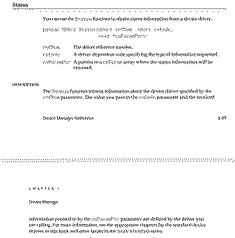

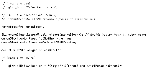

The technical note indicates that you can detect the driver version with a Status call. The version is a single byte.
Uh oh. Inside Macintosh Devices says the version is a word (a short, aka two bytes).
Let's see how to make a status call. Got it? Status(refNum, 9, &myByteOrShortVersion);
Making the Status call the naive way I describe above results in memory corruption. I just haven't played with Status calls enough to understand the weak documentation. It turns out that the Status call always copies a much larger structure (22 bytes) over to the provided pointer, even if the driver only populates a byte or a short. I made the choice to use the more complicated but definitive PBStatusSync (new naming convention) call with the full ParamBlockRec structure. Then, I read only the portion relevant to the serial driver version -- which is a byte (not a short).

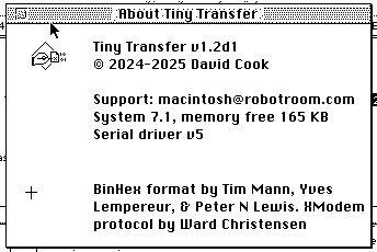

After doing this, the Tiny Transfer About Box now includes the serial driver version:
Here's what I've found so far...
// Serial driver versions
// Version 0 is ROM based - not verified
// Version 1 is the RAM version - not verified
// Version 2 is the Plus ROM - not verified
// Version 5 in IIci with System 7.1
// Version 9 on PowerMac 7100 with System 8.1. Supports 115 and 230
// Version 9 on PowerMac G3 with System 9.2.2. Supports 115 and 230
// Version 10 on a PowerMac 8600 (604ev@300) with System 8.1. Doesn't support 115 and 230
That last line is the killer. The Power Macintosh 8600/300 has a newer driver (version 10) which dropped support for the faster baud rates. What?? I assume this was a mistake as the later G3 switched back to version 9. I need to try installing the Serial DMA extension from Apple to see if this will override the ROM version and restore the faster baud rates.

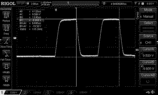

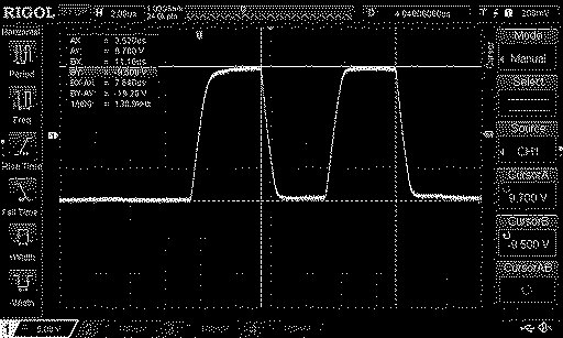

I broke out the oscilloscope to determine if something is wrong with Basilisk II. I believe there is.
First, here is a Quadra 840av transmitting at 230400. The RS-422 voltage only swings from 4.4V to -4.5V. That's within Apple's specs. The width of two bits measures 8.760 microseconds. (It was easiest to reliably measure the end of the start high bit, across a low bit, to the end of another high bit). So, each bit is 4.38 microseconds, which is approximately 228310 baud. Given that I measured by eye, I'd say that's 230K.
Now let's look at my PC running Hyperterminal at 230400. This is an RS-232 signal going from 9.5V to -9.8V. So, maybe the difference in voltage levels at such high speeds is the source of communication errors. The width of two bits is 8.68 microseconds. Which gives 230414 baud. That means the Mac and PC are close enough that there should not be a problem.
Now let's run Basilisk II at 230400 (same PC, same USB adapter). Uh oh, the width of two bits is 7.64 microseconds, which is 261780 baud. That's too fast.

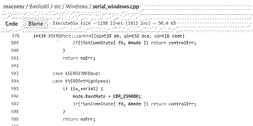

Welp, there's the problem. They are using 256000 baud because there doesn't seem to be a predefined CBR value for 230400 baud. I can't locate an answer online for generating the correct baud rate.
And another problem that I noticed, 14400 is missing. This is an easy fix.

Oct 19, 2025 - #6
>> David Cook said:
Welp, there's the problem. They are using 256000 baud because there doesn't seem to be a predefined CBR value for 230400 baud. I can't locate an answer online for generating the correct baud rate. Click to expand...
Interesting! It appears that the DCB structure also allows just setting it to an arbitrary number, according to Microsoft's docs. For example the CBR_115200 constant is simply defined as 115200. It might be worth trying to patch the code to see if assigning 230400 "just works" for you.
It does appear that the higher bit rate likely won't work on all hardware, though. My motherboard's built-in COM port doesn't accept 230400 or 256000 in PuTTY, but an FTDI USB-to-serial cable does. (I didn't test if the requested rate was actually applied though). So you might want to see if PuTTY allows you to open the port as 230400 with your hardware before trying.

>> dougg3 said:
It appears that the DCB structure also allows just setting it to an arbitrary number Click to expand...
I did not previously notice the line "This member can be an actual baud rate value"

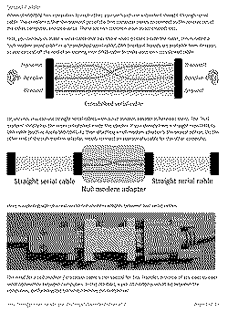

I've not tried any of that. Just wanted to confirm if that's the proper way of going about it. If it is that simple, that's awesome! Click to expand...
Almost. You just need to put a null modem adapter between the two cables.

I did a comparison test with FTP yesterday, results are in the Data Transfer Rates section.
MacBinary II (transferred as raw data, in the Binary mode) encoded files are indeed faster to send over the wires. You get about a 10% speed hit, ish, by using BinHex encoded ASCII files. I don't think that is really a big deal with smaller files.
By your estimation, how much extra bloat would be added to Tiny Transfer if it supported MacBinary II?
