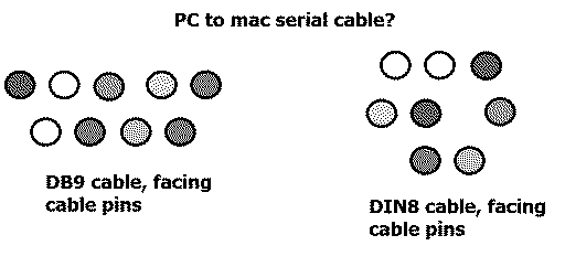

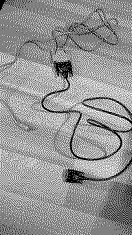

I bought a cable on ebay blindly, it was cheap, and the wiring doesn't look promising. this is the diagram of how the pins are linked together on both ends of the cable

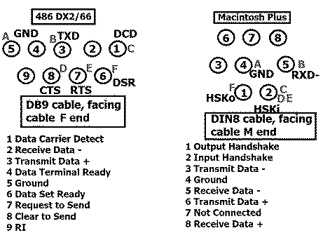

Here's how the continuity works out between the 2 ends of that 2 cable chain:
Again, doesn't look perfect!

1) are there some extra pins that need to be connected? I'm guessing yes, because the connectivity doesn't clearly show a 2 way connection
