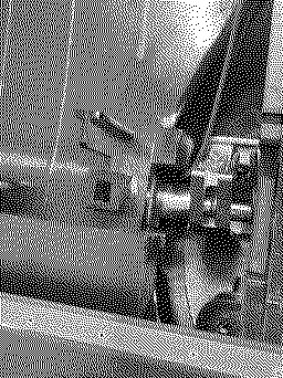

Aug 15, 2025 - #7
Sorry thought it was in service source but it's not. Here's the part.
IMG_6507.png [View]

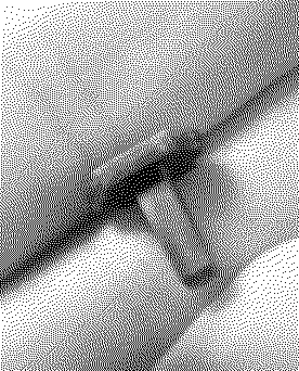

I think I have a new version of this.
I have like this square thing and this switch on the board...
IMG_6556 Medium.jpeg [View]
IMG_6557 Medium.jpeg [View]
Aug 15, 2025 - #9
You're missing the plunger that pushes in the switch

Ohhh.. do you have a better photo of that piece, maybe I could replicate it.
Aug 15, 2025 - #11
No but you should be able to work backwards by measuring the hole the 'pin' goes through and the enclosure parts where it rests. Good luck!
