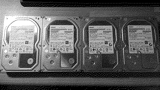

I ended up indeed getting some Mellanox ConnectX-3's from eBay - not bad for about GBP19 each. One in the R520, one in my desktop. A single 5M DAC from FS links the two together. I created a test iSCSI share that ran solely over the Mellanox on the R520 (2TB) using the primary RAID0 boot volume for the VHDX storage. Speeds were NUTS! Exceeded 300MB/sec, peaking around 340MB/sec, for the 56GB .mkv i sent over to it (Aliens Re-Mastered Directors Cut in 4K). I think that'll be fast enough.
Now the only thing I was lacking was the disks themselves. As @bakkus has mentioned, RAID50 was a bad idea - so here, i'm going for a standard RAID5. Doing it like this also allows me to expand it by a further 2 disks when I need to. IE - in 2 months time, when i've likely filled it :D
Therefore - after a boatload of overtime, I pulled the trigger on these:
That's 4 x HGST HUS726060AL4210's - 6TB, 12GBps SAS drives. Total cost? Well i offered GBP30 per drive, to be cheeky...they accepted!
System Supply Industries in the UK has you covered for 2nd hand enterprise gear and it is CHEAAAAAP! Why bother with a Synology when you can get an R520 or R520 chassis with CPU and RAM for GBP100 and 18TB of disk space for GBP120 on top?
I've setup a separate NAS VM for it, with iSCSI enabled - the idea is, I'll browse for files on my desktop, download them locally to SSD, punt them over the iSCSI super quick, and the VM will share everything else out locally via the internal Hyper-V switch to the PleX VM and via SMB to the rest of the network.

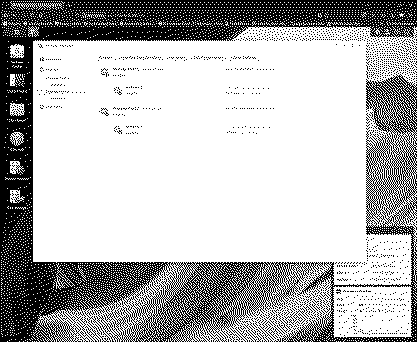

The NAS VM was binned off - getting it to work right just did my head in, so i've decided to run the file sharing on the root Hyper-V instead, makes the volume management easier.
Transferring files over now is just...[drooling-face]
Mounted the file share as a mapped network drive in write-through mode to disable any SMB caching for more consistent transfer speeds - 550MB/sec for the whole duration of a file transfer, instead of 900MB/sec for a short 5 second burst, then a sharp drop and wobbly 150 to 300MB/sec.
Not bad for GBP120 outlay!

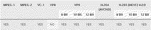

An nVidia Quadro P620!
Think of it as a wierd in-between model, sitting in the middle of the GT1030 and the GTX1050 - a GT1040 if you will. Based on the same Pascal Architecture, the GP107 in this has a full NVENC block, and this is precisely the intended use - not for rendering or graphics, but for video transcoding.
The P620 can handle, for encoding:
...and for decoding:
It lacks AV-1 support but honestly, I have zero AV-1 content, so de-nada!
What's really cool is that it's a single slot card - uses 47watts max, can handle 8 concurrent encodes although it's more limited by the amount of VRAM on the card.
Judging from the *extremely cool* calculator here: https://www.elpamsoft.com/?p=Plex-Hardware-Transcoding
this means the card can transcode TWO simultaneous 4K streams on PleX. And for 1080p? It's not even going to break a sweat, given that the most load i've had at once is three concurrent streams of mostly 1080p content.

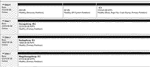

MAKING A MEGA STORAGE ARRAY!
I added the additional four 6TB WD RED SATA disks to the bottom row of the Rackstation - to create a separate array solely for Veeam Backups.
D: is the 'old' R520 RAID5 array, E: and F: are iSCSI volumes on the Rackstation - I think I have in total, roughly 100TB of storage, at least for now.

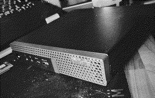

Then a few days passed and the PCIe Riser adapter I purchased finally arrived off the boat, tarriff-free, from China.
I had bought a basic Intel X520-DA2 a few days earlier for GBP17, removed the low profile bracket from it and thanks to UntrustedSource on Printables, I 3D-Printed a new custom bracket to mount it in the M720Q:
Fitted perfectly!
