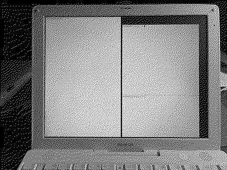

Before moving ahead to Booting the system with the installation CD, I found through trial and error that initializing the target drive can be problematic per the Handbook. Therefore, I suggest doing it via MacOS X per the following:
  1. Boot your iBook G4 into MacOS X using an external Firewire drive with a compatible version of MacOS X. I have a clone of Tiger on an external Firewire drive and used that to boot the iBook G4 into MacOS X Tiger.
  2. Format the target hard drive in your iBook G4 via Disk Utility. Select Apple Partition Map, and format the disk as a single partition, We'll reformat it later once booted in the live CD. It goes without saying that this destroys all content on your internal hard drive, so make sure you have a backup if you need to save anything.
These are important steps to ensure the APM is written as the first partition at the beginning of the disk - otherwise the disk won't boot the system. Once you've formatted the disk in MacOS X, you can shut down the system and resume in the Gentoo PPC Handbook with the Booting subsection. Side note: I could not get mac-fdisk to successfully initialize the hard drive from the live CD environment, which is another reason why I did the initial formatting under MacOS X. Save yourself the hassle and do the initial format under MacOS X.

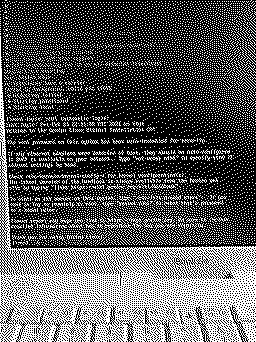

Now you're ready to boot your iBook G4 with the live CD. Follow the directions in the Booting section. Ignore the references to yaboot here and in subsequent sections - the Handbook is in error. Latest Gentoo installation CDs use grub for a bootloader, which we will also use in our installed environment later. Select Boot live cd kernel ppc, and don't worry about boot options - I did not have to enter any. Note that if you don't select anything and the grub bootloader times out, the default boot option is ppc64 which will throw errors and hang your iBook G4. If the boot is successful, you see some instructions displayed on the screen (more on that in a moment) and will be greeted by a command prompt.
Pro tip - once booted with the live CD, use ssh from your modern machine to log onto the iBook G4. I highly recommend using ssh for the installation because you can copy-paste from the Handbook into your ssh session on your modern machine, which makes command line entry much easier and less prone to typing mistakes!
To enable ssh, ignore the Optional: Starting the SSH daemon instructions in the Handbook and instead follow the instructions on the screen on your booted iBook G4 as shown above:
/etc/init.d/sshd start
passwd root
(you will be asked to enter and confirm a new root password)
These steps start the ssh daemon on the iBook G4 and establish a password for root in the live CD environment, which you'll need for ssh-ing from your modern machine to the iBook G4. Note that ssh-ing as root is only allowed from the live CD - it won't work if you try to ssh as root in the installed system later.

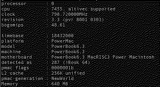

Use cat /proc/cpuinfo to verify CPU, which will be handy for setting CPU FLAGS later. For an iBook G4 you will see "cpu: 7455, altivec supported" along with other pertinent details such as those shown below:

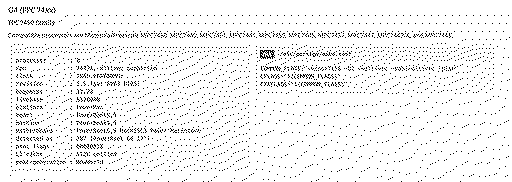

For CFLAGS and CXXFLAGS, recall the cat /proc/cpuinfo to verify CPU? At the following link for Safe CFLAGS scroll down to the G4 (PPC74xx) section where you'll see the following recommendation for COMMON_FLAGS:
Change the COMMON_FLAGS entry in /mnt/gentoo/etc/portage/make.conf per the above. (Note that before executing the chroot command later, we need to specify the full pathname to the make.conf file. Once chroot is executed on /mnt/gentoo, the path /etc/portage/make.conf applies.)
Next is MAKEOPTS. Although the PPC is single core, I found elsewhere to treat the PPC as if it had two cores. Therefore, add a line MAKEOPTS="-j2" to the make.conf file.
These are the only changes needed at this time. Later we will work with USE flags, but that will be after the kernel is compiled and we're moving on to building applications.

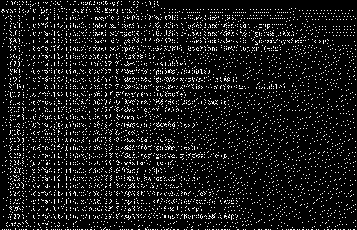

Now it is time to select a profile. Here is another choice than can bite you if you choose unwisely. For me, the initial list had #12 preselected, I switched to #10.
Why #10? I wanted to experiment with a desktop environment and I figured Gnome was fine (KDE was not offered as a choice). The Handbook explains about these choices, and it is better to select them and not use them than the reverse. (In the end I decided not to install Gnome for reasons I'll explain later.)

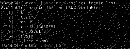

Configure timezone and locale per the Handbook. When selecting a locale, pick one with utf8. You'll thank me later when you try to compile the X Window System and it throws compilation errors at you if you don't.

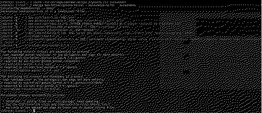

It took about half a day to compile the kernel. The emerge command compiles and installs the kernel and initramfs in /boot directory on the root partition.
Pro tip: format your emerge command by surrounding it with date and time commands like this:
date; time emerge <emerge command details>; date
This will print the time and date at the start and end via the date command, and the time command will yield time statistics for the emerge like this:
real 551m4.248s
user 479m45.255s
sys 54m42.439s
Yes, the example emerge above took 551 minutes to complete (i.e., over 9 hours) - it was for the awesome window manager which I'll discuss later.
Once the kernel emerge is complete, here is the result you should see in /boot. Ignore the grub and NWBB directories - those will be created later when we configure the bootloader. If you do this later and the linux kernel is updated, you'll see a different version (6.7.4 is the current linux kernel version for Gentoo at the time of this writing).

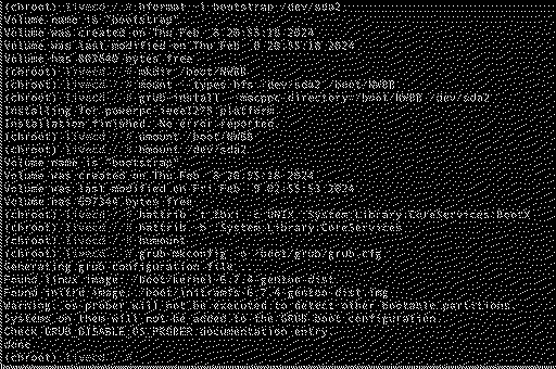

install and configure grub per the Handbook. I did the steps exactly as listed in the Handbook, even if the reformatting of the bootstrap partition seemed like an unnecessary step. Do it anyway per the Handbook - it will work. In the example below, the bootstrap partition is /dev/sda2 per the earlier setup, and yours should be too.
By the way, during the time I was attempting to get Gentoo working on my iBook G4, the preferred bootloader switched in the Handbook from yaboot to grub. Originally, I tried yaboot but couldn't get it to work, even after applying patches to correct some compilation errors. The bootloader section has clearly been updated to grub, and it worked perfectly. Not all the earlier sections in the Handbook were updated from yaboot to grub, hence my earlier note to mentally substitute grub for yaboot in the Handbook.
Skip all the alternative bootloaders on the page.

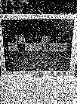

Towards the bottom of the page is Rebooting the system. If all works, you will boot into your installed environment!

The livecd disk presented a black screen near the end of the boot sequence. This is fixed by entering a kernel parameter in the grub menu, "nomodeset" with no quotes.
