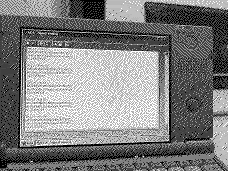

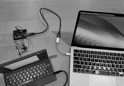

It's been a few months since I have actively worked on this, but I am starting to think about it again. Over the past few years, I have achieved some small milestones. These are going to be super condensed and a bit vague, simply because it's been a few months since I've worked on this, but it might give anyone who is interested an idea of where I am at.
1. For now, I have selected IrDA as the method to get serial data into the laptop. I would like to do this with an ESP32 with a small battery that you could pair a Bluetooth mouse to.
2. After some trial and error, I managed to use an Ardunio Uno, an IrDA encoder/decoder IC, and cheap IR LED to enable uni-directional communication from the Ardunio to the Libretto via HyperTerminal. It took a long time to get to this point!
3. Next, I was able to get bi-directional communication working as well using the same IrDA encoder/decoder IC. It basically takes serial input, and turns it into IrDA, and vice-versa. Support hardware is very simple: just the IC, a clock crystal, a cheap IrDA LED, and a cheap IR photodiode that came in my Ardunio kit. It's all cheap, accessible, and repeatable.
4. Next, I shotgunned Arduino sketches with Claude.ai, asking it to generate fake serial mouse data for me. Windows didn't seem to notice the "mouse", so I started looking into how Windows discovers mice, and found that it toggles the DTR (data terminal reset) line, and expects to hear something specific back from the mouse in a tight timespan. It doesn't look like the concept of DTR exists in IrDA, so this didn't go anywhere. I tried shotgunning a few sketches that would spam the response from the mouse while the machine booted, but that didn't work either. Finally, I shotgunned an Arduino sketch with Claude.ai that would advertise a Plug and Play device, and that got some movement - Device Manager picked it up as a mouse! That tells me that the serial data is making it to where Windows 95 can see it. Sadly, I couldn't get any fake mouse movement to work - just a "dead mouse" in Device Manager.
5. I played with Claude.ai some more, asking it to write me some IrDA protocol analysis output via the terminal on my Mac. It gave me some interesting stuff, but nothing that broke new ground.
So, what now? I might be getting back to a point of looking at this project again. My next step is to connect a real serial mouse to my Arduino, and read the output from it to see how it behaves. That might help me figure out how to get Windows 95 to detect my Ardunio as a mouse. I am a bit worried that I might end up having to write a driver for Windows 95, which is way over my head... but with large language models as infinitely patient teachers, who knows.
