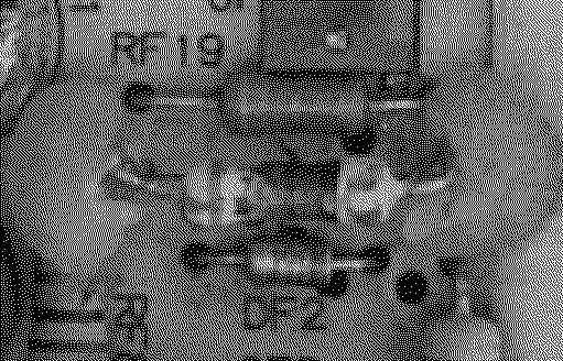

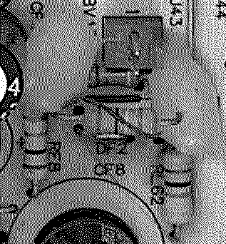

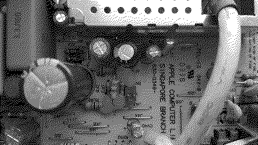

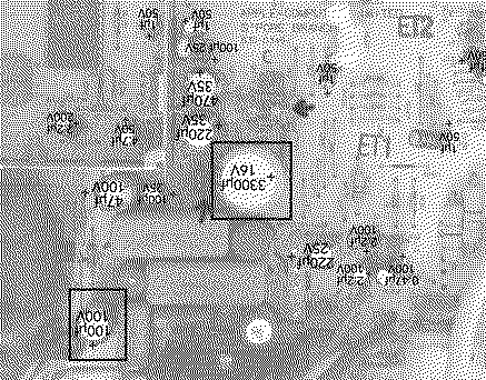

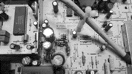

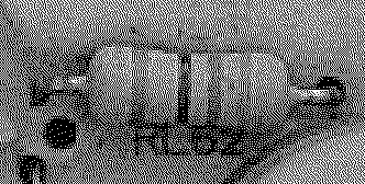

When I got this machine, the logic board had been fully recapped and the analog board partially recapped. The display and soft power both worked, but the picture was pinched horizontally in the middle, like an hourglass. The DL21 and DL22 18V zeners were cooked and burned the PCB around them. I replaced them both with 1N4746 and changed the rest of the AB caps, except for the ones in the shielded cage. RL62 was cooked and open and I replaced it with a metal film 47Ω resistor.
Now when I turn on the rocker switch, the machine starts immediately (no soft start), chimes normally, but there is no picture. There is high frequency noise in short chirps, at about 3 per second, as if the AB is trying to start the display, but can't. The neck of the tube is not glowing.
I've confirmed cap polarity repeatedly and the newly installed parts don't appear to be under distress. No smoke, smells or noises.
I measured 47.5V at the center pin of the horizontal output transistor, but I'm not sure if this is the right place to get the B+ rail.
Out-of-circuit measurements:
RF11: 363Ω
RL62: 48Ω
RF8: 1.4Ω
RL22: 100Ω
RF19: 4.7Ω
DF2: Not shorted
Running measurements:
12V Rail: 11.6V
5V Rail: 4.9V
Center pin of horizontal output transistor: 47.5V
Some questions:
Is RL62 47Ω? My old part was too damaged to read so I replaced it based on the parts list below.
What type of diode is DF2?
What is the role of the DL21 and DL22 18V zeners? They are not populated on the LC575 AB.
Which components are involved in generating the B+ rail?
Where is the best place to measure B+?
Any help or documentation is greatly appreciated. I did find this parts list:
I've also attached it (html renamed to txt) since most CC resources seem to have disappeared.
[Image: 20230213_235519.jpg][Image: 20230213_235802.jpg][Image: 20230213_235814.jpg][Image: 20230213_235834.jpg]
Thanks.

Feb 15, 2023 - #2
I downloaded the attachment in the opening post, but I needed to change the extension from .txt to .html and then I could view it. Nice info!
I spoke with Kay Koba, who is truly my Sensei about all things related to the CC, and he is unsure about the root cause. He is concerned about the extent of the burning. So am I. It's clear the voltage regulator must be working, otherwise you would not have been able to measure anything close to 12V or 5V.
The issue here is what caused the burning in the first place:
1. Simple failure of one of the components in that area which lead to others burning?
2. Failure of another component which caused a high current draw in the burned area?
The fact you swapped out the burned components with good versions and still get nothing indicates the root problem must be outside the burned area. I say that because it seems your trace repair was good, so that cannot be the issue.
Hmmm...

Feb 15, 2023 - #3
The issue here is what caused the burning in the first place : 1. Simple failure of one of the components in that area which lead to others burning? 2. Failure of another component which caused a high current draw in the burned area? Click to expand...
DL21 and DL22 burning up seems to be a common problem and pictures of other boards look similarly damaged to mine. These are two zeners in parallel in the same direction, for the apparent purpose of sharing the load, which isn't a great design. With or without the replacement parts, the behavior is the same.
It's clear the voltage regulator must be working, otherwise you would not have been able to measure anything close to 12V or 5V. Click to expand...
The low voltage rails are fine, other than soft power not working anymore. If the 47.5V I measured is the horizontal voltage, then it's too low and I need to figure out where it comes from.

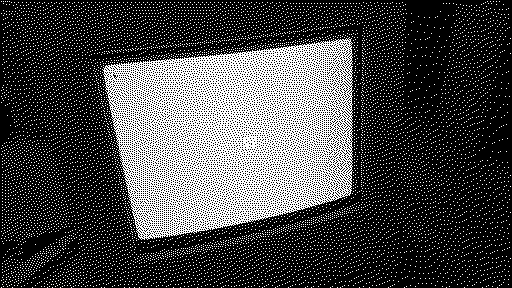

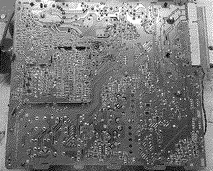

Feb 15, 2023 - #4

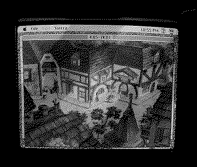

I now have soft power and a picture! :)
I found a tiny solder shaving bridging two pins on IP11. I don't think I reflowed it during the course of the recap but removing the shaving did the trick.
[Image: 20230215_013221.jpg]

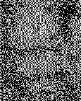

The hourglass distortion is now gone, but I noticed some occasional flickering which coincided with arcing sounds so the flyback may have problems.
[Image: 20230215_013753.jpg]

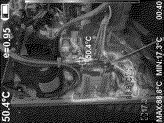

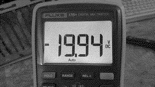

I'm keeping an eye on voltage across the zeners. There's a good chance they burn out like the originals did. I'll find a single replacement with a higher rating.
[Image: 20230215_013837.jpg]
This video by @techknight was helpful for making sense of the board.
My understanding is a 24V input is current limited by a resistor, then clamped by the 18V zeners (which are absent on the LC575). I'm not sure what the output of this circuit modulates though.

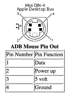

I am quite curious about Soft-power having worked originally when you got your hands on that CC, but then after recapping, you said the machine powers on immediately by the mere flip of the switch on back (which should not happen).
We know that soft-power is merely the grounding of pin-2 of the ADB connection, as per this diagram...
Something must be pulling pin-2 (normally a HI +5V logic level) to GND for the minimum required duration of what I believe is 200ms or longer. Have you probed that area of the circuit?

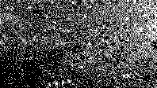

Feb 17, 2023 - #7
Have you probed that area of the circuit? Click to expand...
It turned out to be a shaving of solder bridging the pins of a transistor. After fixing that, soft power worked again and so did the display. B+ voltage increased from 45V to 60V under load.
I then tried to adjust the display using the rear pots, but when I did, RL62 began smoking. I shut down power immediately and replaced the single 47Ω resistor with four in a series/parallel arrangement for increased power handling. I also swapped DL21 and DL22 with a string of 1N4001 for the same reason. That bought me enough time to properly adjust the display.
I also tried to reduce B+ voltage by adjusting the PP1 potentiometer, but it was glued to prevent tampering. I wasn't able to remove the glue without ruining the pot, so I swapped in the one from my LC575 board. That one was not glued. I'll have to order another 1K pot to replace it.
I think these parts are underrated for the power they're subjected to and having the display out of adjustment seems to stress them further. It might explain why I see the same parts burning up on other boards.
[Image: kq5.jpg]
kq5.jpg [View]

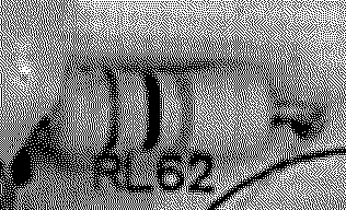

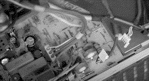

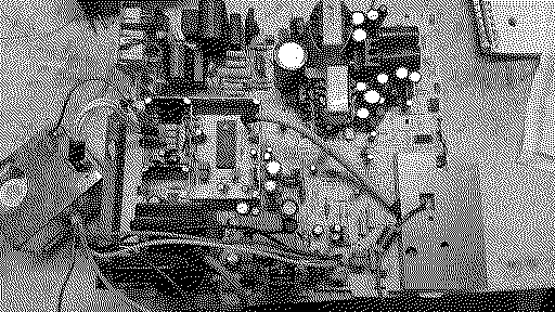

Feb 17, 2023 - #8
Wow! So it looks like things are working now. And all because of a tiny shaving of solder!
But can you show me where in your photos RL62 is located? I Googled up other CC analog board photos but can't seem to find it inside the shielded cage. (And I don't have my CC open in front of me to check.)
And when you said RL62 began smoking, that your new, metal-film replacement of the same wattage rating as the stock resistor, right?
The only scorched area on my CC's analog board is the PCB under these two diodes...
Those same diodes also charred the PCB underneath in this photo by @Branchus ...
And the resistor I marked with a red arrow in his photo also seems to have overheated.
1676608458554.png [View]
1676608609707.png [View]

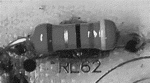

YMK
Joined: Nov 8, 2021
Posts: 408
Likes: 343
Feb 17, 2023 - #9
This was my RL62 before it went up in smoke. The four that replaced it are still holding up:
1676611389285.png [View]
Feb 17, 2023 - #10
Thank you!
Very interesting that your blue, 1W-rated replacement also burned. So by saying "4" you mean you have the equivalent of a 4W resistor in there now?

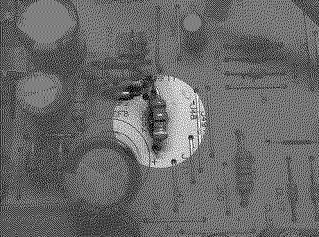

Mar 28, 2023 - #12
>> YMK said:
Out-of-circuit measurements: RL62: 48Ω Some questions: Is RL62 47Ω? Click to expand...
Just wanted to add further clarification to this thread, since some questions in the opening post were never answered, and people finding this thread over time may have the same questions. Yes, RL62 is 47Ω. But tolerance seems to vary.
In your photo, the stripes, from right to left, look like: YELLOW, GRAY, BLACK, GOLD, BROWN
But "GRAY" can't be right because in photos of my own board and that from Bruce, we see that "gray" stripe is in fact "purple," which means it is a 47Ω resistor. But even if GRAY was right on your board, that would make it 48Ω, which is only 1Ω higher than the resistor on my board and that of Bruce.
Even so, your RL62 has 5 stripes which means it is a 47Ω 1% resistor (assuming that GRAY looking stripe to be PURPLE), but the resistors from my board and that of Bruce have a 5% tolerance as per the fact there are 4 stripes and the 4th is gold.
It's hard to find 1% tolerance high wattage resistors, but I think 5% should be fine, in which case, this 3W resistor might be a suitable replacement, for people who don't want to solder 4pcs of a 1W 47Ω in there:

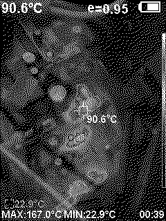

Mar 28, 2023 - #17
>> YMK said:
I'm only using one. Click to expand...
Thank you for that clarification!
>> YMK said:
I don't know what the common failure modes are with 84V. The active components might benefit from better heatsinks. Click to expand...
When I made my VGA mod video, I spent a lot of time researching the matter because there was a fair amount of incorrect or misleading info out there on the web. Even in the Doping Mac book mentioned in my video, I found a small error. And while the info about the 84V version mod is fairly consistent about it being "harder on the analog board," most of that is copy/paste from something said more than 20 years ago. It is logically that a higher voltage would result in more current flow and therefore more heat, and heat does kill. But aside from that talk, we don't see any hard facts about failures or which components get much hotter.
If I had a Flir or similar, it would use my iPhone to check the heat of all the components when the standard VGA mod is running. One can then take an educated guess on which of those hottest components would be even hotter with the 84V VGA mod, and then consider how best to cool them. It could be that a fan mounted on the analog board and blowing across components would be all that is needed.

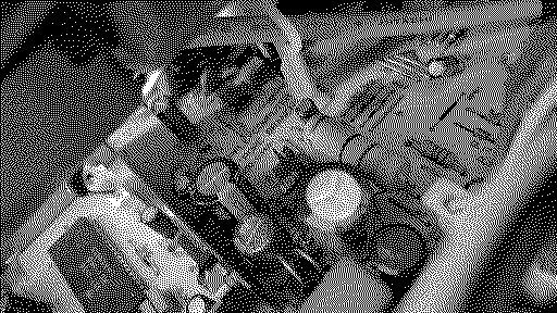

Mar 29, 2023 - #18

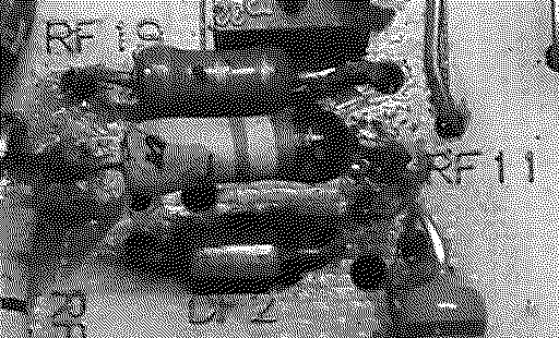

I assume you swapped out your burned RF11 as well, because it looks quite burned indeed...
On my board it looks like this...
Looks like RED, YEL, BLK, BRN, but BRN must be GOLD. But RED, YEL, BLK, GLD = 24Ω, which can't be right.
If we say it is ORG, YEL, BLK, GLD, that is only 34Ω, which can't be right.
ORG, WHT, BLK, GLD = 39Ω, which can't be right
ORG, YEL, BRN, GLD = 340Ω, which could be right.
ORG, WHT, BRN, GLD = 390Ω, which sounds right based on what I found below.
On this video by @Branchus , Bruce says it is 390Ω...
But what befuddles me is what looks to be a wire wrapped right across the resistor in my photo above. And I can sort of see that in the photo by @Branchus too, wrapped across the right side leg anyway...
Not sure what that is because I don't have my CC torn apart in front of me.
Anyway, I assume you used a 5W 390Ω replacement for RF11?
By the way, if you keep watching that video by Bruce, I can see 1N 52 markings on DF2, but I can't read the rest.
1680079005991.png [View]
1680079054528.png [View]
1680079277987.png [View]
1680079478707.png [View]
Liked by YMK
Mar 30, 2023 - #19
Another thing that has me baffled is why there is hot-glue only on that RF11 resistor. There are a number of raised resistors on the board, but they don't have hot glue on them. What is so special about RF11 that necessitated hot glue? Hmmm...

[Image: 1680194031589.png]
I can now identify DF2 (1N5237B), which was not present in the parts list I posted above.
This board also has (part of) the "wire" wrapping the resistor you mentioned, but it doesn't seem to be conductive. Maybe it's some remnant of the packaging?
If I had a Flir or similar, it would use my iPhone to check the heat of all the components when the standard VGA mod is running. One can then take an educated guess on which of those hottest components would be even hotter with the 84V VGA mod, and then consider how best to cool them. It could be that a fan mounted on the analog board and blowing across components would be all that is needed. Click to expand...
I do have one of those...
The oversize RL62 isn't too hot, but the stock RL22 at 167C might be an upgrade candidate as well.
Fortunately, these flybacks don't seem to run as hot as the monochrome compacts:
I will probably upgrade the horizontal output heatsinks on both boards whether I attempt 84V or not. Here, it's running 640x480 at 71.9V.
