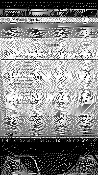

We have been troubleshooting quite a fair bit outside the forum and we have not really figured it out. Either there is something seriously wrong with my machine or the ROM is really picky when it is a C650. I have however dug up the appropriate tools to change the gestalt ID to Q650. I'll get back to you when I have a. bricked the machine or b changed the gestalt ID and tested the ROM that works in Jockelills Q650.
Meanwhile, this is our most recent barn find. That 2400/4800 modem is a beauty..
[Image: IMG_2940 2.jpeg]
[Image: IMG_2938.jpeg]
IMG_2940 2.jpeg [View]
IMG_2938.jpeg [View]
Liked by Jockelill

So, I got inspiration tonight and started the mod from Centris to Quadra following this thread https://tinkerdifferent.com/threads/marchintosh-2024-overclocking-a-centris-650.3387/
When it was time to install the 1.2kohm resistor it turns out that I didnt have any. I found a 1kohm resistor and thought "close enough"... Turns out that 1kohm gets you gestalt ID 51... :)
