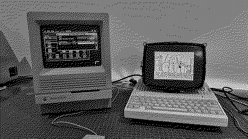

[Image: 20211221_154419.jpg]
The naked CRT is the CRT module for the IBM 5155 , but all it needs is 12V and an ntsc composite video signal.
The video is inverted with CloseView , with magnification turned off , but leaves a tell-tale zoom box see bottom right , its also a little slow.
[Image: 20220101_130928.jpg]
There is an invert video program , I have that running on the IIci here running in 1bit , no performance hit.
and I wrote a little program to un-invert the corners so they remain black
InvertCorners_VintageMacintosh/invertedcorners.jpg at main - retrotheory/InvertCorners_VintageMacintosh
Utility for removing or restoring the rounded corners on vintage Macintosh desktop - retrotheory/InvertCorners_VintageMacintosh
[Image: 20220101_130959.jpg]
The SE30 is currently running an SE board and invert video program wouldn't work, so I used CloseView. I think invert video program will run on a real SE30 just have not tried it yet. The IIci is using a color monitor running in B&W 1bit, but externally RGB are mixed to give amber effect.
[Image: 20220101_145130.jpg]

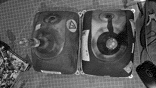

[Image: tubes.pg.jpg]
The 5155 tube has the anode cap on the opposite site with respect to the end connector.
I had to extend the wires to rotate the board so it would fit with the anode cap in the same location.

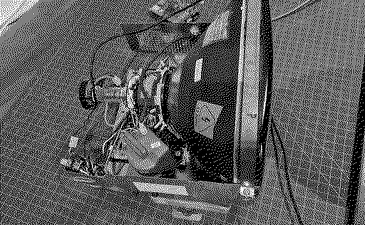

[Image: extension.jpg]
Kept the mac open for picture adjustment
[Image: adjustment.jpg]

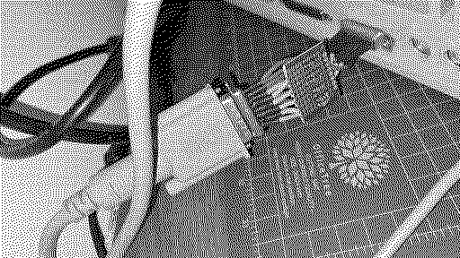

OK, I just went through the process and am happy with the results. I'm not using my MacEffects SE/30 super regularly and it clearly isn't my "true to the time period" machine. Here's the results, and I'll share my experience with the switch. after.
So, my plan was to do a "swap", but I wanted to keep my SE/30 CRT with the original case, just in case I wanted to fully restore it to a stock machine later. But I did have a Mac Plus with a bad analog board or PSU, that had a nice looking CRT (no burn in). Removing the CRTs went pretty smoothly, thanks to. good disassembly videos for the 5155. However, you can tell IBM at the time did not have the attention to detail that Apple had - they used so many different screw head types in the same machine, I'd hate to have been a IBM repair tech working on these back in the day.
Once I got the CRTs extracted, I was able to break the yoke's free pretty easily. As @RetroTheory says, the way for this to work is to keep the yoke with the machine, and swap out just the CRT tube itself. However, after getting the shielding installed and the CRT back in the 5155, I found something that others may want to know. The pins on the neck of the Mac Plus CRT were too thick to allow the neck board to be attached. I was applying as much force as I felt comfortable doing and it did not want to go in. I didn't want to risk breaking the neck of the nipple and ruining the CRT
However, I did have a Mac SE for sale that that I figure I could check. It does appear the pins are a bit smaller on the SE's CRT. Before reassably, I did test the neck board and it went on with a bit of friction, but not a ton of force was needed. So, I'm not sure if all Plus CRTs have thicker neck pins, but maybe try to use SE or SE/30 CRTs if you want to do a swap and put the Mac CRT into the 5155 like I did.
Another item of note is that I decided not to try to extend the cables and simply put the anode cap hole on the opposite side for both machines. This allowed me to have the neck boards oriented the way they originally were. The only slight inconvenience I found was that it was a bit harder to get the anode cap removed or accessed to discharge it. Not sure how long a bleeder resistor takes to discharge a CRT, but I definitely got some pops when I was working on the 5155. So either it doesn't have one, or it does have one but mine isn't working, or I was expecting it to work faster than it does.
Finally, there's probably a trick to it, but I struggled a fair amount trying to tighten the yoke clamp without moving the yoke and throwing it out of level. I wonder if some hot glue would have helped stabilize it until the clamp is tightened. I eventually got it to work, but it was a tad frustrating.
Thanks all! I guess now I need to learn more about the 5155 to see if I can get it working. I know there's a FloppyEmu like device, so that will be the start. Thanks all for the information!

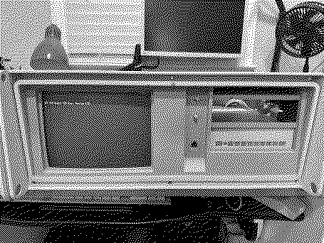

>> jdmcs said:
I am having trouble finding technical documentation on the IBM Portable Personal Computer 5155 (which I'm going to simply refer to as the 5155 from here on out) in regards to the voltages that the analog board can output to the CRT. And from seeing Adrian Black try to repair a terminal recently, I learned that some CRTs require different voltages than others. (I, too, had thought that all monochrome CRTs used roughly the same voltage). I also have a 5155 with a broken CRT on the way to me. It seems like the easiest repair would be to do a tube swap. While I have been unsuccessful at finding an amber CRT (much less a Zenith CRT like IBM used), Macintosh CRTs are readily available. And while it seems anathema to put a Macintosh CRT in a PC, that's better than having no display at all. (Yeah, I know I could plug in an external monitor, but if I'm lugging my 5155 around, I don't want to have to lug a monitor around, too.) Which leads to my question: can you put a white phosphor CRT into a 5155 and it actually work? Better yet, has anyone done it? Click to expand...
It definitely is possible. See my note above about the Mac Plus CRT neck pins not working. I'd grab one from a newer SE machine to be safe. But it worked quite well.
