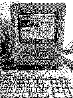

Mar 27, 2022 - #14
I used the image mentioned above and it worked nicely
That image worths of deeply checking... it's full of goodies! [+1]
