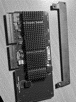

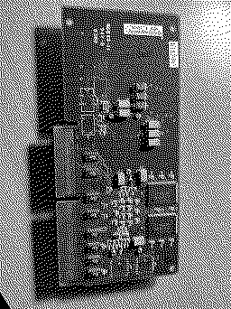

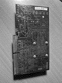

Can you include some photos?

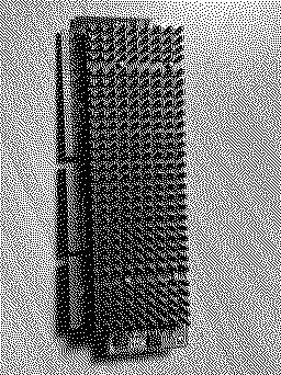

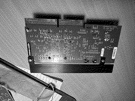

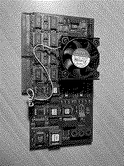

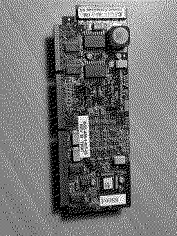

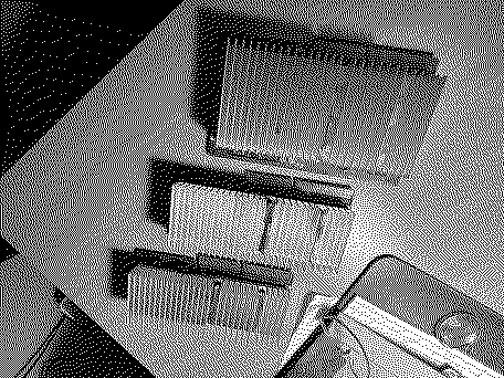

Mar 14, 2025 - #7
Others.jpg [View]
NewerTech_rear.jpg [View]
NewerTech.jpg [View]
Sonnet_cache_rear.jpg [View]
Sonnet_cache.jpg [View]
Sonnet_G4_rear.jpg [View]
Sonnet_G4.jpg [View]
