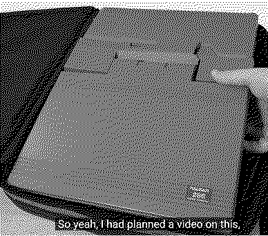

The Halikan's original broken plastics

1762805588194.png [View]
